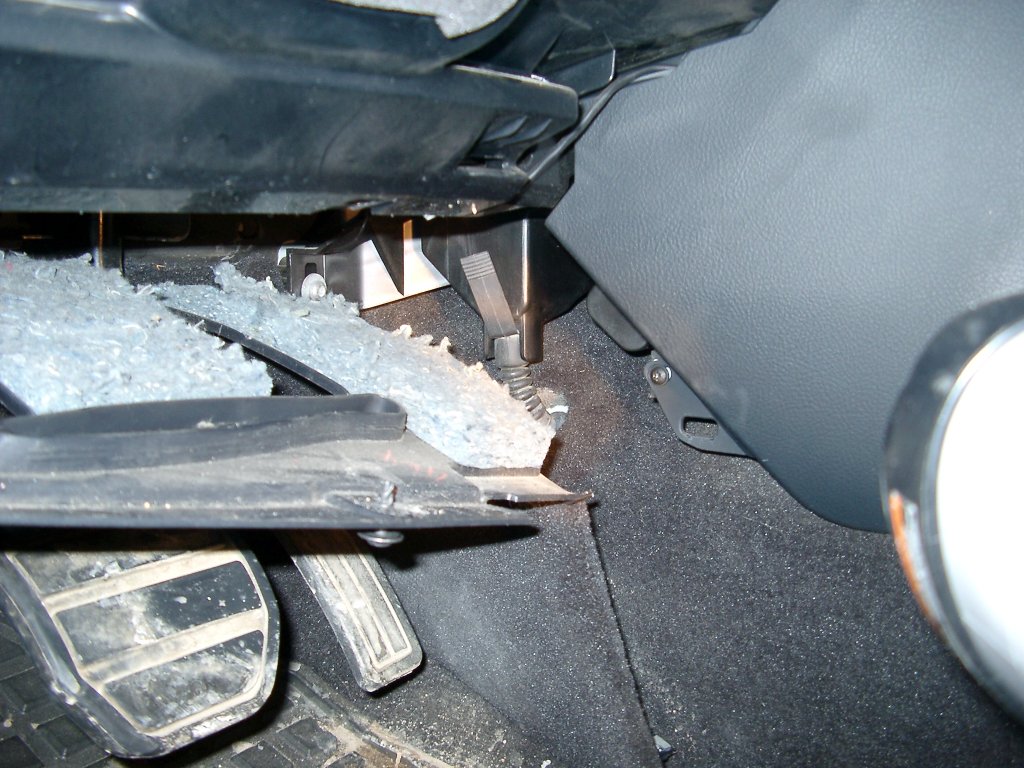

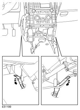

Per above where the post says the drain is accessed from the cabin, the attached link shows the AC drains on either side of the transmission ****. In my case, for my LR3, it was not plugged drains but the drain hose thru the floor was disconnected and hence the water soaked into the floor carpet. It was just a case of sliding the hose back over the drain *** off the AC ducting.
The are a couple of link to files re the drain. One has over 1800 views so some must have found it useful.
Here is the link to the other HVAC system related files such as the stepper motors.
