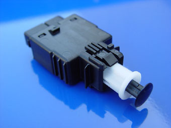

Could not locate brake lite switch on stock local. Next day best price Auto Zone 24.95. To get use of the Rover untill part arives, remove plug from switch . It is a four pin switch, make a jumper wire and plug into the two on the flat side of the plug. ( left side installed ) Turn the key on and take out of park, turn off . Remove jumper wire and reinstall plug on switch for brake lites.Good to go, BUT if you put in park --- just anothe jump. If you jump the wrong two wires the brake lites will lite, not to worry.
