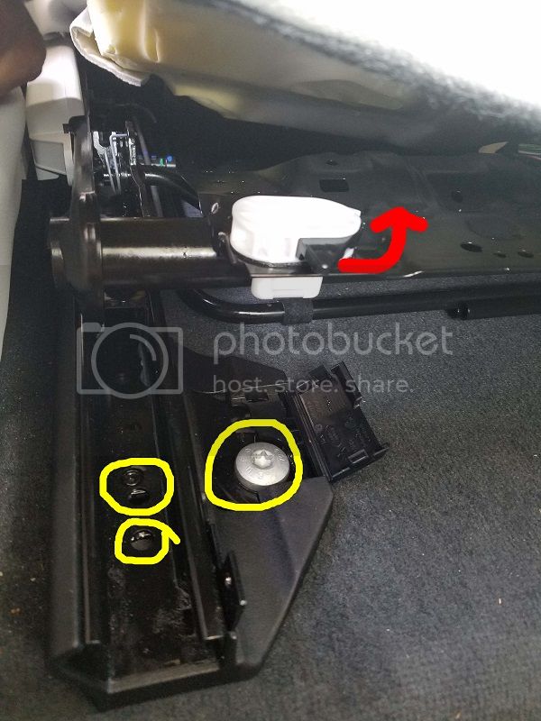

I've looked though many posts about the squeaking noise from the back seat. I've tried them all but for this new re-introduced model there was nothing I can find that would help me cure my anxiety from the constant squeaking noise.
Highlighted in Yellow - This is the source of my squeaking noise. I applied WD-40 Silicone to the 3 areas and that got rid of the noise.
Highlighted in Red - Other posts suggest that this is the noise but it was different for me. This noise is rather like rubbing Styrofoam. The squeaking noise that I had was like a creaky old bed, or like the old NYC yellow taxi.
Hope this helps some of you that have to deal with the squeaking.

Hi Michael - I'm experiencing the same issue with my 2016 Range Rover Evoque. If I put either side of the 2nd row seats down, the squeak goes away. But if both seats are up, it's an annoying squeaking noise, like an old bed, metal squeaky noise. I was trying to see the "yellow" areas you highlighted that you applied WD-40 to, but I can't see. Is there a way you can post the visuals again?
