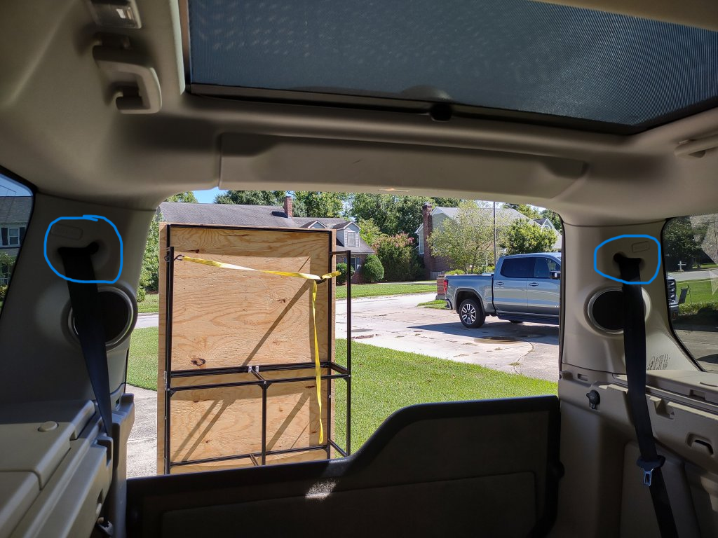

I was out working on the LR4 today so I took some pics.
Below are the plastic trims in the cargo area w/ the seatbelts:
Below are the latches for the seats. You'll need the whole carpeted piece for each side because the lap belt comes through a slot in them too.
