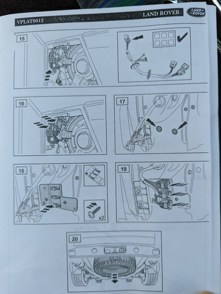

Adding trailer wiring harness and stuck on the rear bumper area. Looks like I have to remove the rear bumper cover as something is in the way of the harness connector mounting plate. Can anyone confirm that is the path to take? The instructions do not seem correct as it is not listed, at least not for MY16. Any help appreciated. Thanks.
I do not have access to area in 17, 18, 19. Something is in the way even if I could get down to it.

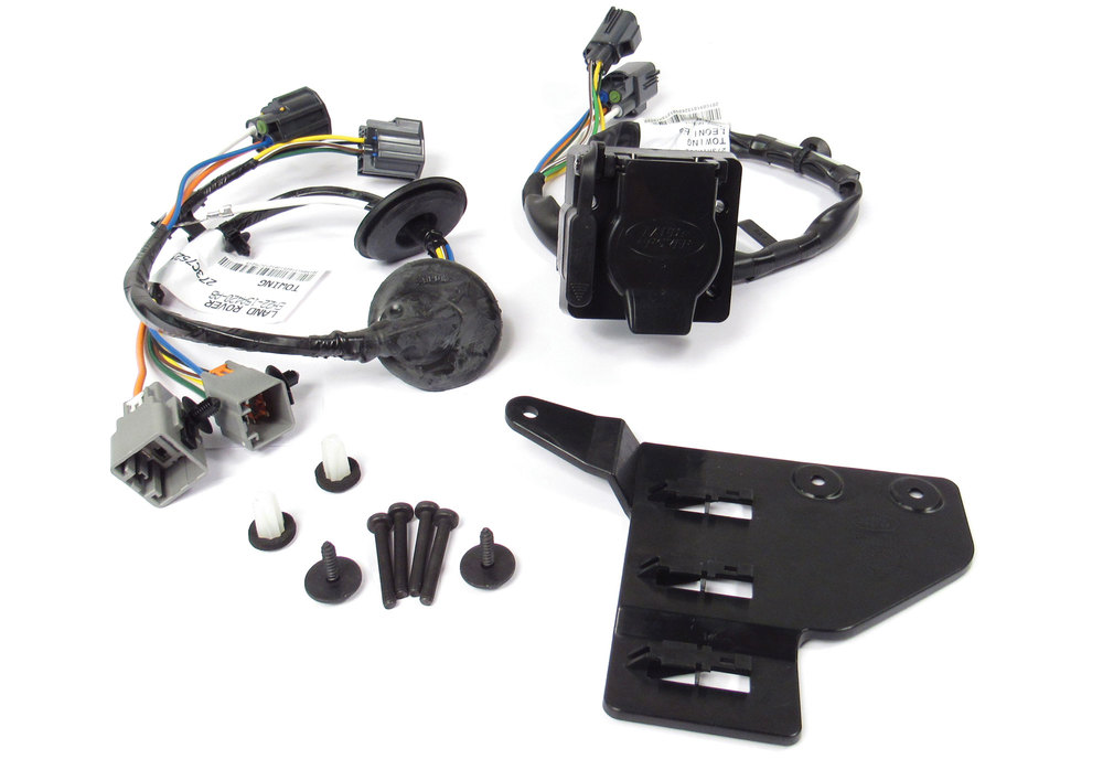

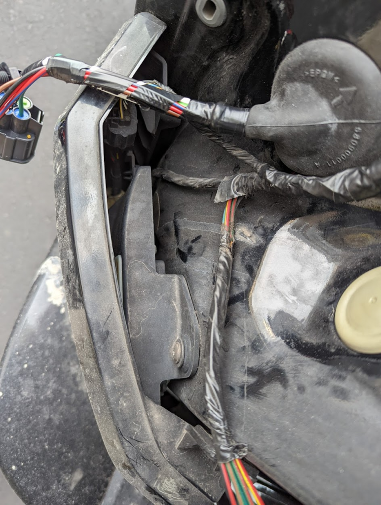

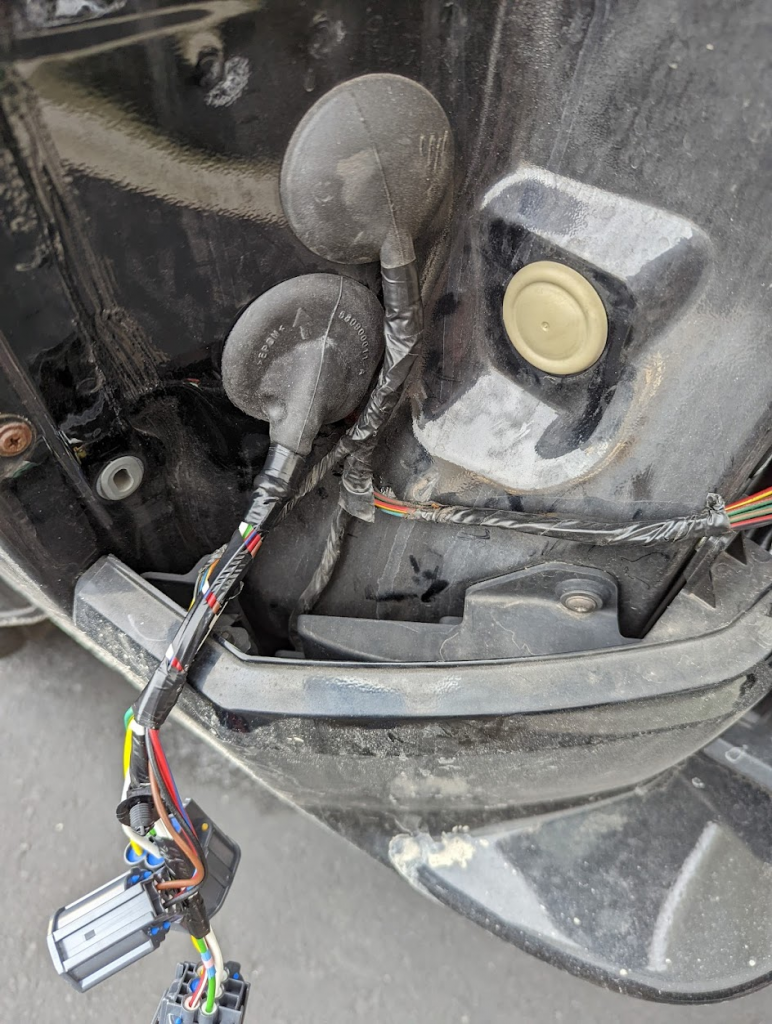

Yes, almost exactly the same. Different hitch plug, and 3 connector coming though lamp hole. Plastic piece in lower right is my issue. The location they want me to mount it is inaccessible.

I believe, by looking at your photos, that piece is just the bracket to hold the plugs in place. If you don't mind just tucking the plugs in between the body and bumper cover, you should be able to finish the install. Your plug should have the standard 7 way connector or the 4 way plug for u-haul trailers.

You don't have to pull the bumper cover off. Just drop the wires straight down and plug in the routed trailer plug coming in from the tow cover. They connect at the corner of that bumper and has plastic fasteners to secure it.
