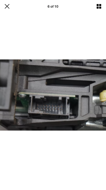

Hi all - I have a 2012 LR4 Lux and have be completing some minor updated - will post pictures soon. When I bought my 2012 I liked the traditional style gearbox but now am wanting the 2014+ style rotary knob found on most rovers today. Is it possible to swap over the 2012 style gear shifter to a 2014+ knob? I belive its do able - however it may just take a bit of effort and someone who knows electrical wiring.
1 - You would need to add paddle shifters which can be done. I write up on how to do so and enabling the function with the Gap IID tool can be found here from Powerful UK.
2- The terrain response and gear shift would need to be replaced. The terrain response is a direct plug and play for the new style. This would need to be replaced to due to where the trim meets on the rotary knob.

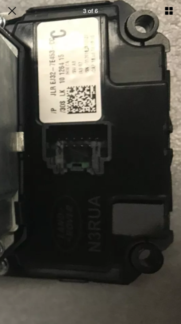

3 - It appears the classic gear box and rotary knob have different electrical inputs. Does anyone know what wire feeds into this? Is it the body harness or something branching off from it? Would a custom wiring harness need to be made?
2012 style gear box
2014+ rotary knob

The rotary dial is part of the 8speed transmission. All V8's are equipped with a 6speed tranny so you can't swap it unless you replace the entire transmission.
