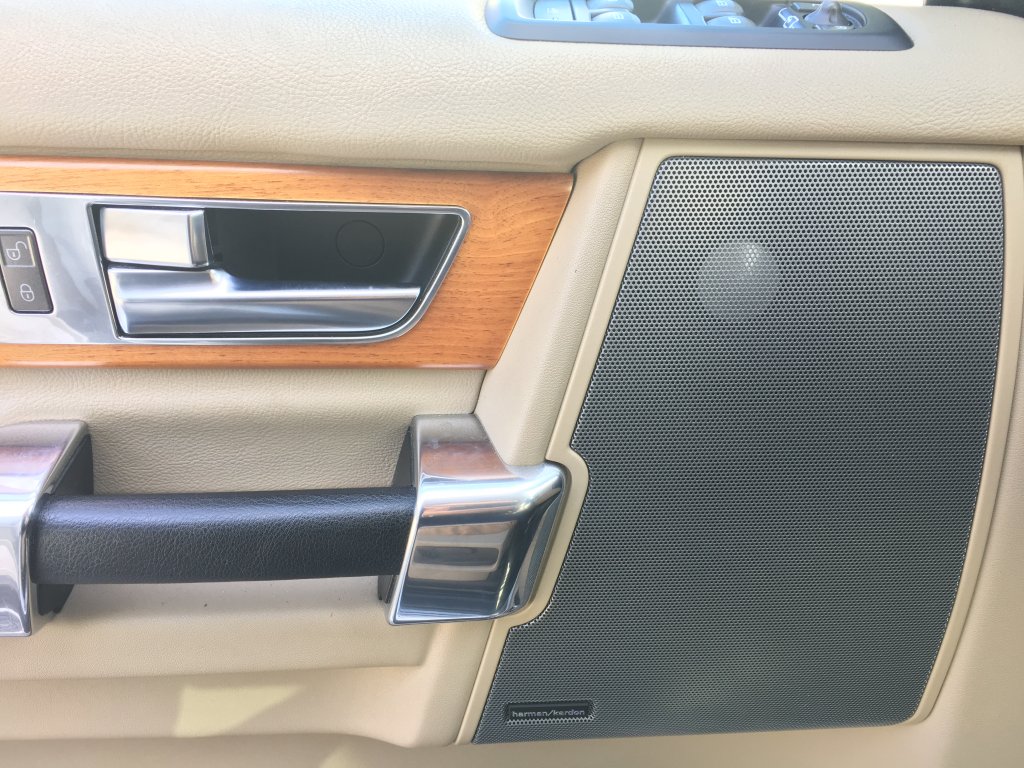

My 2012 LR4 HSE with Harman/Kardon apparently has a blown speaker on the drivers side.
Seems only the bass speaker is blown out.
No audio shop in my area will touch it. Savannah, GA.
I’m trying to avoid the dealer.
Anyone else replace speaker in their door panels?
I need an LR4 door panel disassembly guide/vid? And which speaker to buy.
There’s a bunch of used and new Speakers on eBay, not sure what to get.
I attached some photos for everyone’s review.

There should be two speakers in there in the HK configuration, a mid range (upper, you kind of see it through the grille) and a bass/woofer (lower) speaker. Upper s/b part # LR029719, lower LR057786.
Awesome umberto with all the answers as always. I think I’ll just replace them both to be safe.
