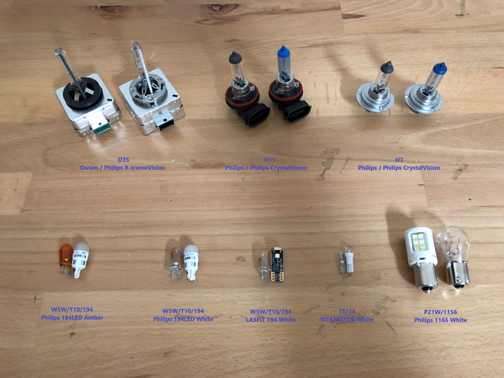

Types
W5W/T10/12961/194 – Side Corners Front/Rear, Side Repeaters, License, Puddle, All Interior
D3S - Xenon Headlight - High/Low Beam
H11 - Halogen Fog
H7 - Halogen Headlight - High Beam
P21W/1156 – Reverse and Rear Fog
T5/74 - Vanity Mirrors
HP24WA - Front Turn Signals
Quantities
W5W/T10/12961/194 - 18 White (interior, license plate, front corners, rear corners)
W5W/T10/12961/194 - 4 White (door puddle)
W5W/T10/12961/194 - 2 Amber (side repeaters)
D3S - 2
H11 - 2
H7 - 2
P21W/1156 - 4
T5/74 - 4
HP24WA - 2
Brands
W5W/T10/12961/194 - Philips 194 Ultinon LED Bulb (White) [Amazon]
W5W/T10/12961/194 – LASFIT 194 (White) Can-Bus Error Free (Door puddle/courtesy lights) [Amazon]
W5W/T10/12961/194 - Philips 194 Ultinon LED Bulb (Amber) [Amazon]
D3S - Philips D3S X-tremeVision Gen2 42403XV2C1 [Amazon]
H11 - Philips H11 CrystalVision Halogen / Philips 12794UNIX2 X-tremeUltinon LED [Amazon]
H7 - Philips H7 CrystalVision [Amazon]
P21W/1156 - Philips 1156 Ultinon LED Bulb [Amazon]
T5/74 - YITAMOTOR T5 Hat 5050 Tri-Cell 1-SMD LED Dashboard Gauge Instrument Panel White Light Bulb Lamp 37 58 70 73 74 12V [Amazon]
HP24WA – Land Rover LR014111, Renault 262610001R, Valeo HP24WA

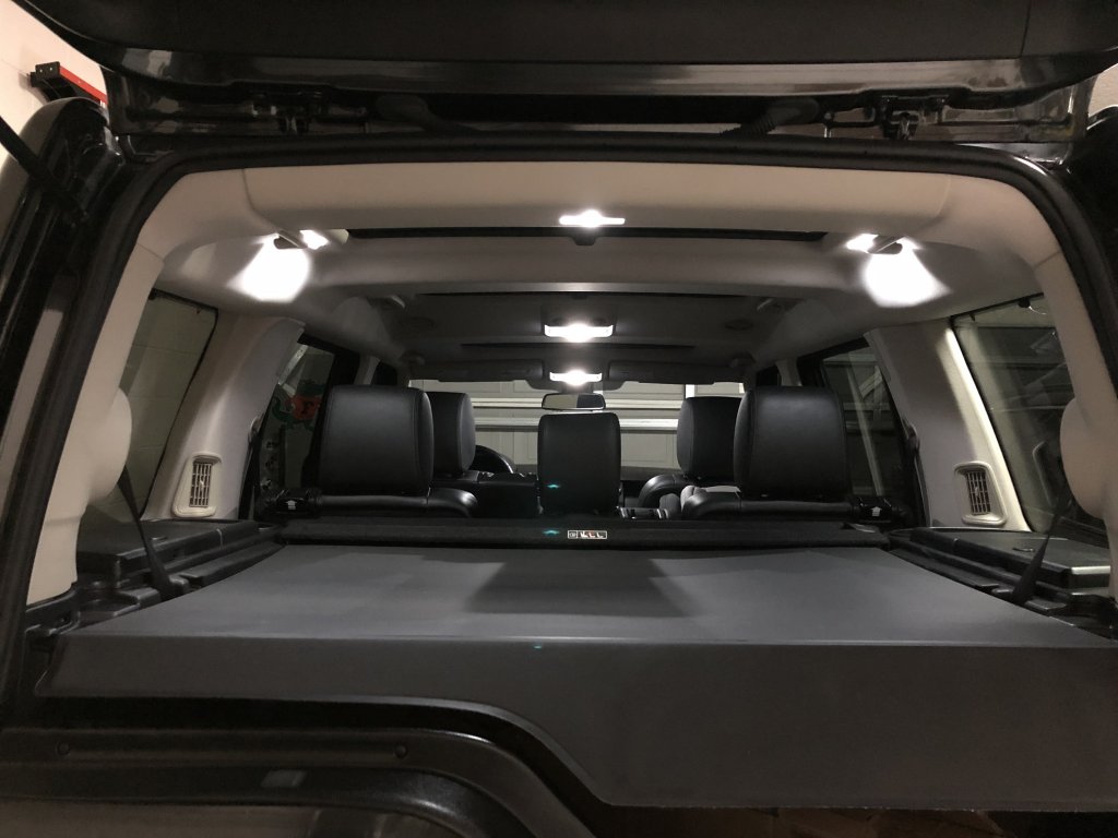

Interior
(2) W5W White, footwells
(1) W5W White, glove box
(6) W5W White, front and 2nd row map/courtesy/dome
(2) W5W White, 3rd row courtesy
(1) W5W White, rear load space/tailgate
(4) W5W White or LED Fixture, door puddle/courtesy

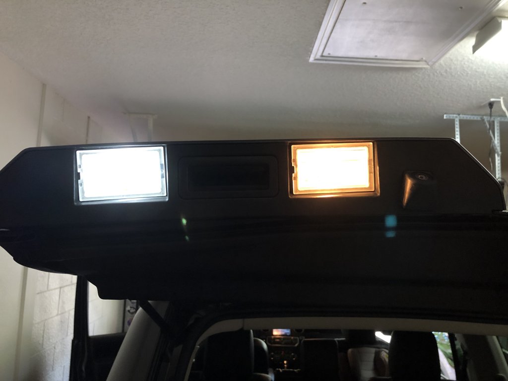

  • Front door puddle/courtesy LEDs are the only ones that did not work with the Philips 194LED bulbs. The rear doors worked fine with the Philips bulbs, but I replaced all four for consistency. The fronts are hit-or-miss, I would recommend CANBUS Error Free bulbs or LED fixtures by PowerfulUK or PMLIT [eBay]. When you replace the bulb, regardless of halogen or led, you’ll need to close and open the door before it will work again.

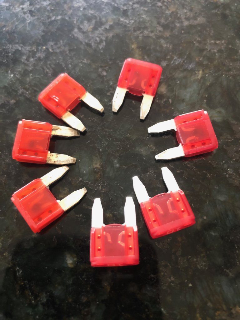

  • If the interior lights, such as the vanity or dome stop working, then you probably blew fuse #57. Just replace it with a 10A mini fuse and you should be back in business or better yet, just remove it until all interior lights have been replaced. I ended up replacing it 3 times, twice just for the vanity mirrors.

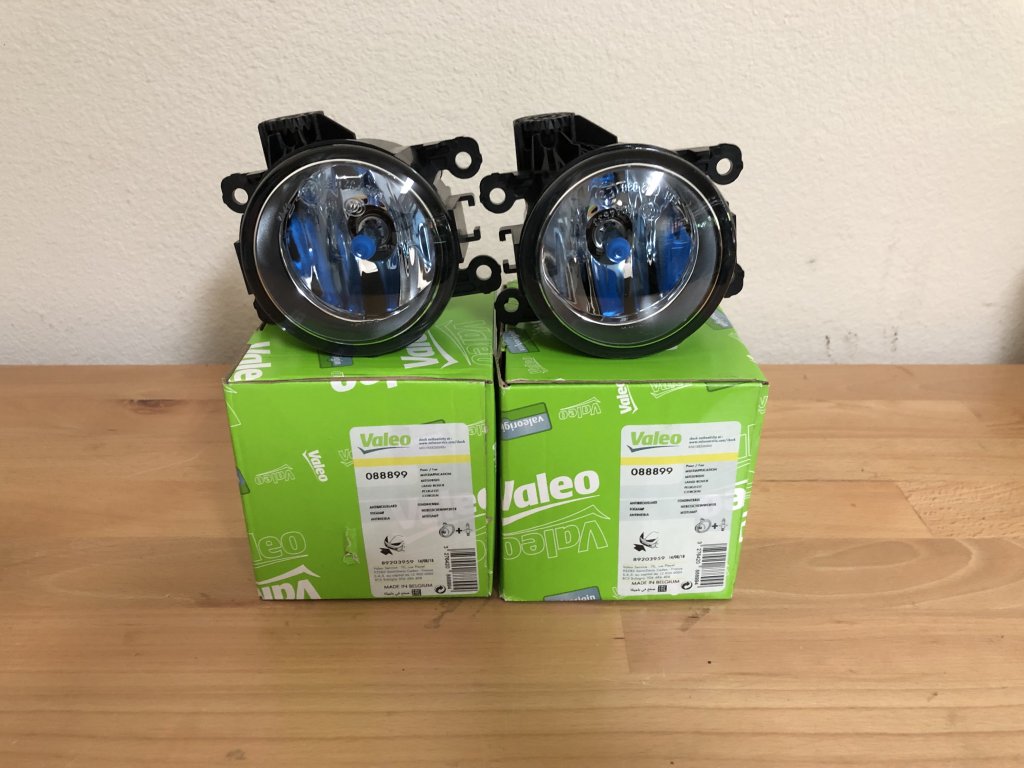

  • Front fog light LEDs are expensive, and I rarely use them, so I just upgraded the existing halogens
  • Replaced beat up front fog light fixtures, Valeo part #88899 [Amazon]

How have the replacement fogs worked out? Have a pic of day/night shot? thank you
My original fog housings were fairly scratched up and a little foggy, so I just replaced the bulbs when I replaced the housings. They new bulbs are brighter, but probably not that much different from the originals.

This is how many fuses I had to change to replace the bloody annoying Vanity mirror lights !!! Man ... could LR make them any smaller and trickier???

Wow, I forgot about that pain, I must have blocked it out! I think I went through half as many, but I remember a small spark occurring while changing the vanity mirror, which gave me a bit of pause, luckily it just required changing the fuse(s) to restore functionality.
