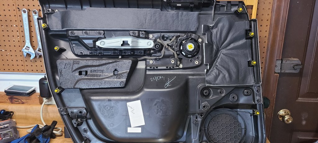

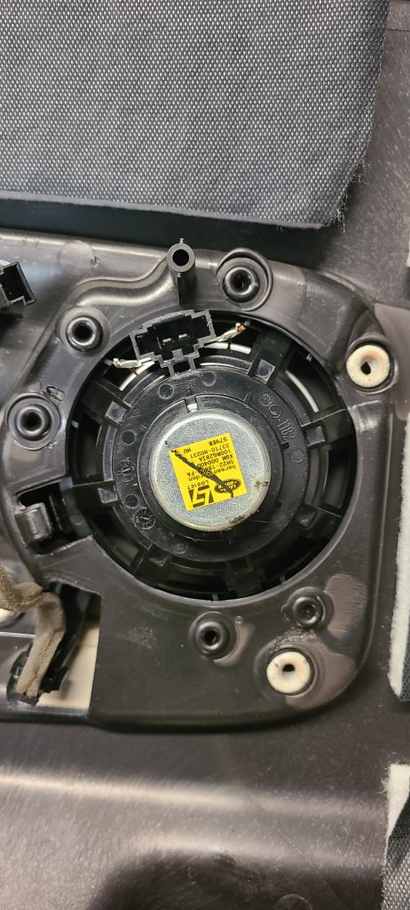

As the title says, I have the door panel off and the darn midrange speaker is encased in the door plastic. Most posts refer to a screw on case/ring that holds the speaker in place but there is none. Or at least I can't figure it out. The speaker area is riveted, no screws. Here is the picture, someone please help!

Did you figure it out? Looks like the sub assembly is plastic/riveted to the panel. I have removed assemblies like this by carefully cutting away the minimum amount of the rivets to free the part. I attach the assembly using a hot glue gun around the remaining rivet structure. No experience with your particular issue, so proceed with caution.
