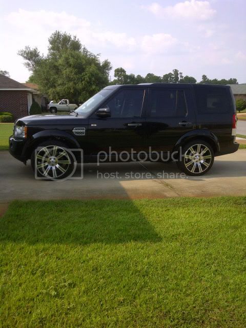

This guy posted a picture of his LR4 with Range Rover Sport (20x9.5") wheels in the Showoff thread.
attachment.php
http://www.landroverworld.org/forums/showpost.php?p=147885&postcount=392
Also posted after this stating that he has no rubbing at all.
