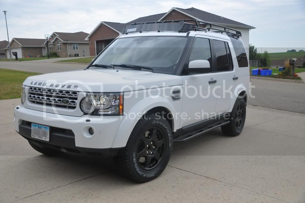

I went with black, but I have a standard HSE Lux Fuji, so im going for the storm trooper look, but without the extra bling black bits.

I need to get some off road pictures, last time I got it really dirty I didnt have my SLR and my phone was basically dead.
