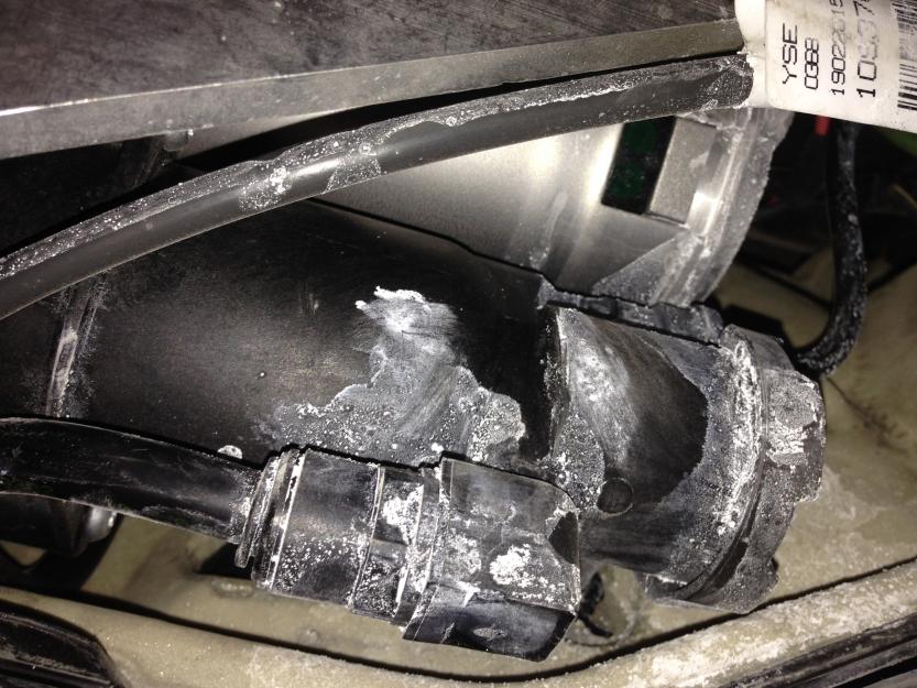

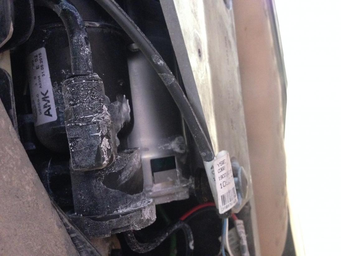

I just opened the compressor cover, found some weird white dust, will upload picture later

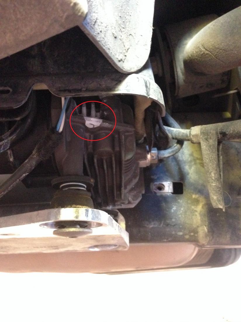

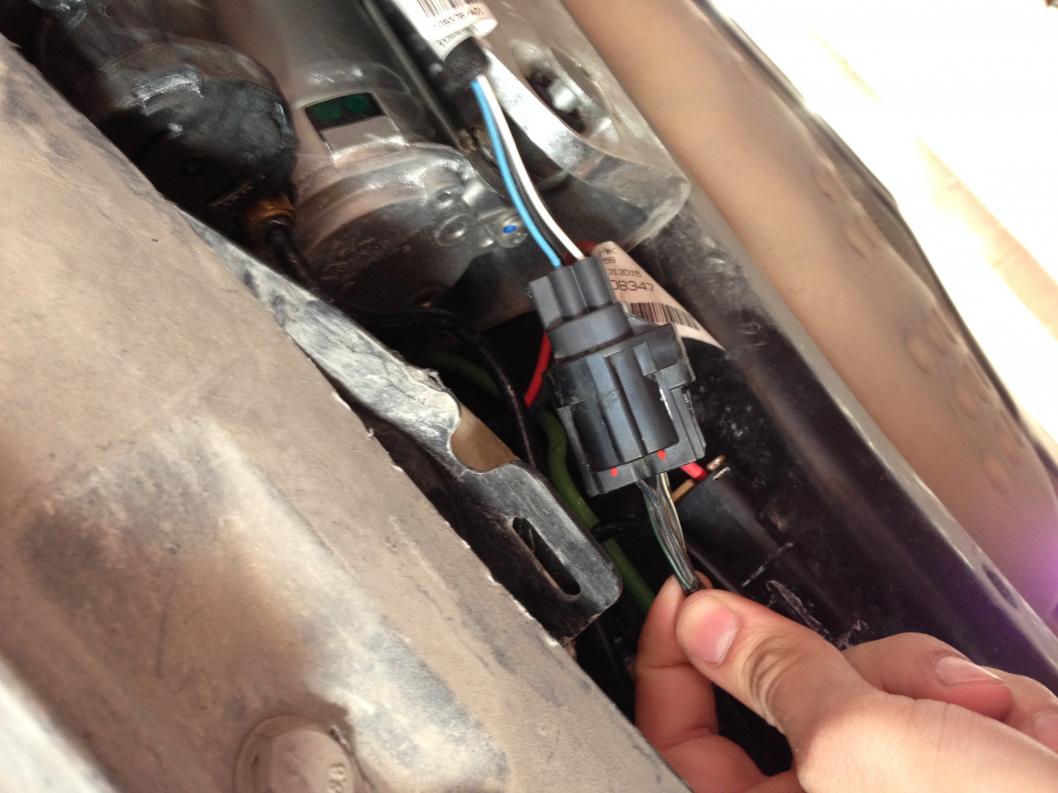

here they are, I am cleaning it, will look for some compressed air like the one used to clean keyboards. How it became so dirty in barely a month of use is well beyond me. I will clean everything but just to be clear, that black thing on the 2nd and third picture is the exhaust ? or where is it?
thanks for the help guys!

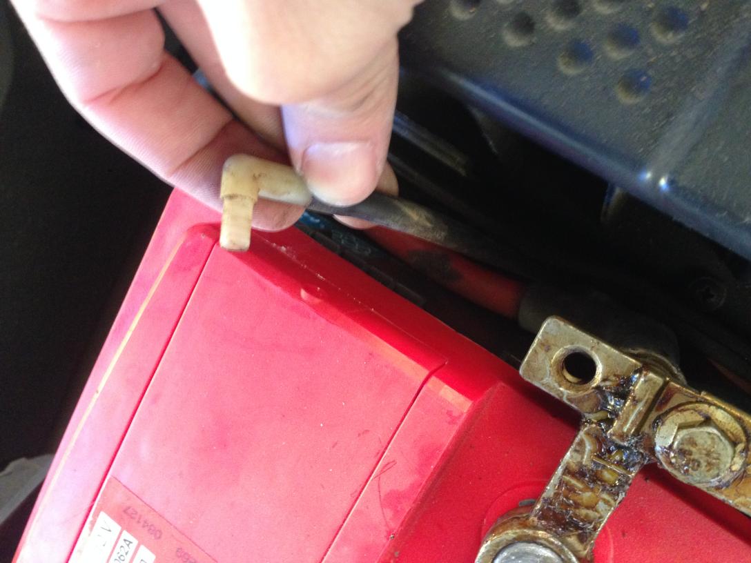

also I was checking the relay and the fuse (they are fine) and I found this unplugged things, I have no idea of what they are, are they supposed to be disconnected??
That's the battery vent hose. Should be hooked up to the battery vent port unless you have an AGM battery, in which case you don't need it.
Oh, and the connector is normal. It's blanked off in mine too. Can't remember what it is. It's either for the auxiliary lights or the smog/pollution sensor or something else. Regardless, it's normal.
Wish I could help there. I know what it looks like on the Hitachi (kind of a pancake looking thing), but not sure on the AMK.

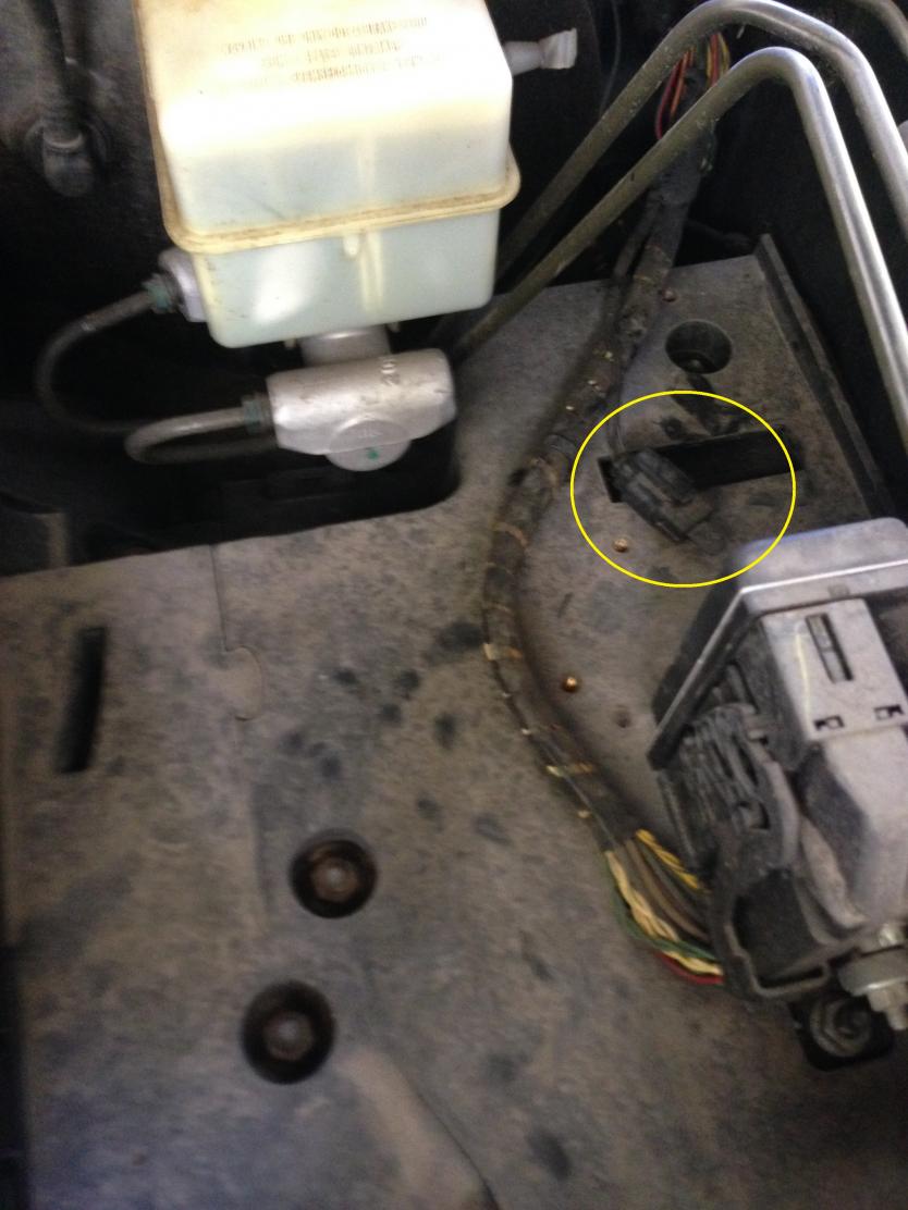

I think I'm up to something:
so upon further inspection I discovered that the **** mechanic was so lazy that he did not put anything back on its place: the valve was not fixed to the frame but literally hanging from the air pipes. And the wires were floating as well instead of properly secured.
So I started putting the air valve on its proper place and while doing it I heard the compressor suddenly beeped and released air pressure !! I want to think this fault is due to a loose wire or something (which should explain the "signal plausibility failure" message) I do not know if I fixed it tho...
Thanks cmb6s I will check the battery I'm not sure if it is agm
Also, is this one supposed to be hanging? I cannot find anywhere to secure it
