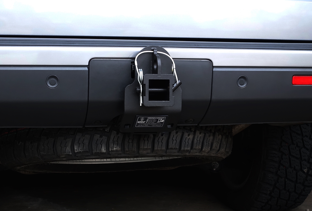

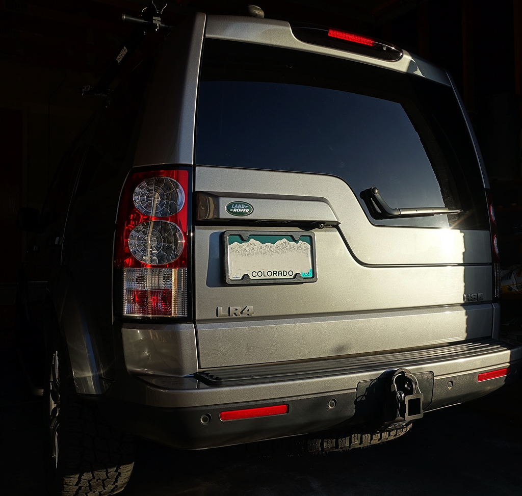

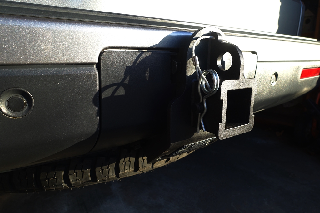

Received my Rhino Hitch from Todd and got it installed this past weekend! :beer:
Hitch is amazingly built, and I want to thank Todd for designing and manufacturing the best hitch hands-down (IMO) for towing with the LR4 & RRS!!! (especially for those of us that are towing heavy loads > 5000 lbs). Very much looking forward to doing some practice towing runs with the travel trailer by the end of the month before the camping season begins.
Here a few quick shots with mine installed (ended up going for the FERROGRAIN finish, which is the more matte finish and also a great match for the lower trim finish on my LR4). A couple shots in the full-sun, and one in the shade.

Thanks very much Chris. I agree with you, the Rhino Hitch installed is a very clean setup. I received your PM, and as you suggested, thought I'd answer your questions in this thread for the benefit of the forum. :smile:
You asked about installation of the Rhino Hitch and if I installed it myself. Yes, the Rhino Hitch bolts on, as well as, interfaces with the factory recovery point on the LR4 (and LR3). Todd supplied both bushings with my hitch, and each bushing is labeled for LR4 or LR3 application. It was easily installed by me, but I took my time making sure everything got tightened and torqued up securely. (I would note that the template included with the hitch to guide you through cutting the plastic cover is not quite exact, so it just required some fit checks and additional cuts depending on how tightly toleranced you want the plastic cover to fit when it is re-installed after hitch installation).
You asked about my impressions (any tradeoffs) after having it for a little over a month. Unfortunately, I can only speak to the non-towing so far (but I will plan to provide some updated info once I've had a chance to tow with it). As far as trade-offs, the only trade-off is that the hitch is physically visible, but I think the design is overall very attractive and unobtrusive (visually, it does lend a rough-and-ready look to the rear of the LR4 I must say).
The hitch does not get in the way at all...no issues or hindrances to accessing the rear hatch and tailgate, and I should also note that I have not had any issues with the parking sensors going off with the hitch in place. I believe Todd specifically designed the hitch to not interfere with the rear parking sensors, so no need to worry about going in and turning the sensors off when not towing. I would note that for those that are towing with a Weight Distribution Hitch (Equalizer, Reese, etc), you will likely need to notch or cut the male insert portion of your Equalizer/Reese hitch bar so that when you mount the hitch, you have clearance to install the safety pin. This seems to be the case for WDH bars only as they seem to be slightly longer than a regular non-WDH hitches (this is the distance from the deepest portion of the hitch bar to the safety pin hole). The low profile design of the hitch receptacle seems to contribute to this. I had to shorten my Equalizer hitch bar by a small 0.25" in order for it not to bottom out against the LR4 tow point, but I don't see any issues with that, as it is such a small change to the hitch bar length. (Todd had a Reese WDH customer that had to do the same thing).
Bottom line, I'm REALLY looking forward to towing with it soon, if I can get the schedule to open up a bit! I definitely want to do a practice tow before we start camping this summer.
Hope that helps.
