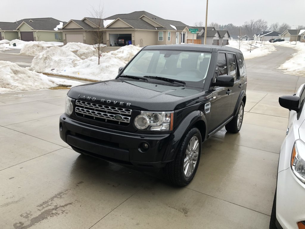

After all that, found a 2012 HSE with 50k with full Land Rover service history.
