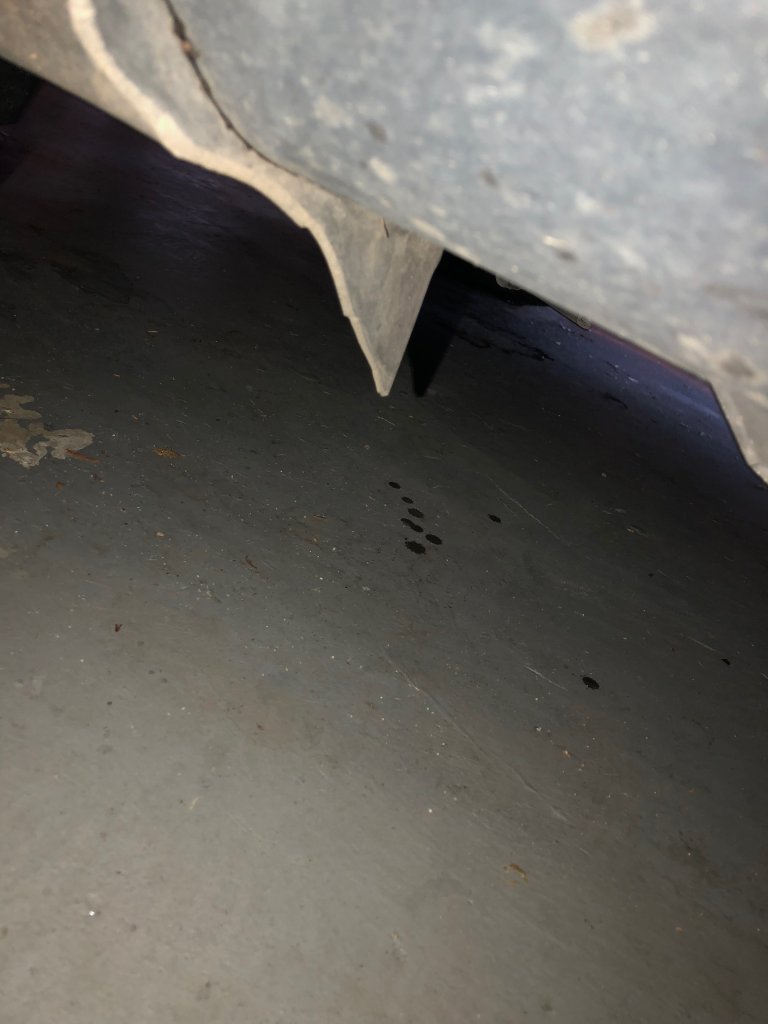

well, i suspected them being bad, threw it up on the lift and couldn't see anything. couldn't move them, too heavy. but on driving there was a little wobble at high speed braking and there was a clunk from light braking while going down a steep hill and over concrete imperfections. then this showed up on the garage floor inside the drivers wheel about 6 inches. HMMM. 48k miles. so it is going into the dealer for that...
