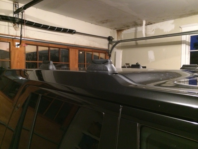

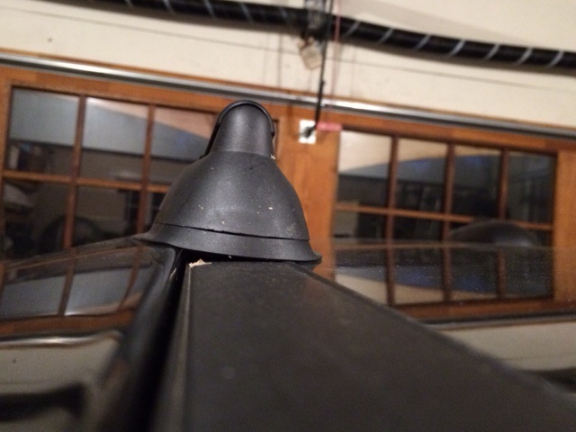

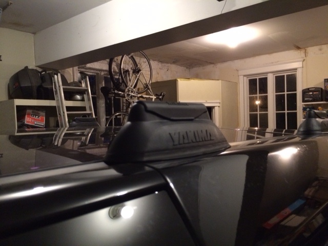

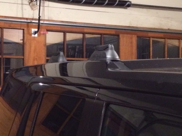

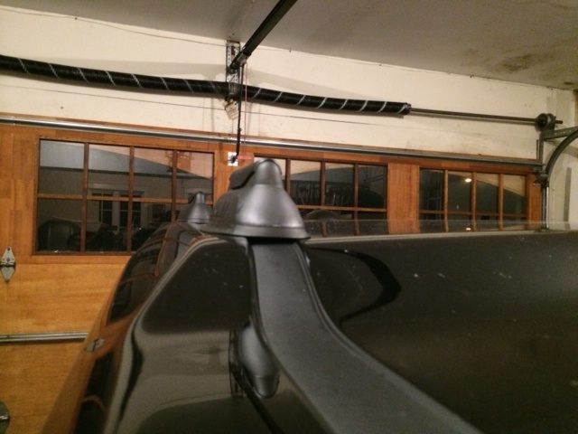

So, a little later than expected, apologies. And, I'm a terrible photographer, so wasn't sure what to show. So, one nice thing about the Yakima set up is that it takes literally a few seconds to take the rack off the vehicle, so here are a couple of pix of the feet that attach.
The pads(feet) are a single bolt attachment, you just pop off the plastic tabs that cover the bolts and bolt the foot on. you can see that foot isn't completely flush since the plastic rail cover isn't flush with the roof in the first place. I think you wouldn't notice this unless you're 6'6" or more.
