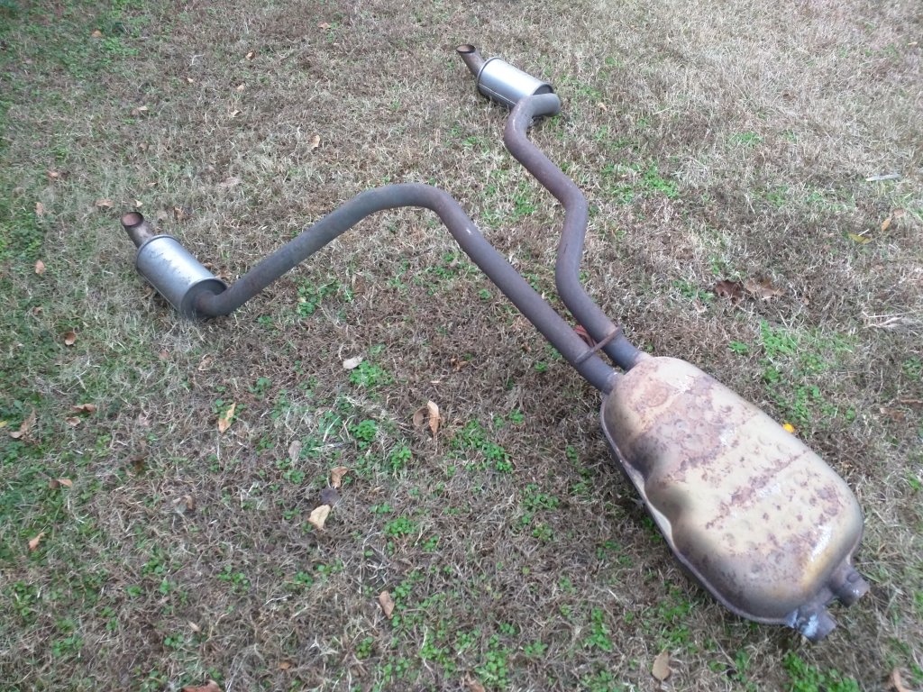

Some folks have cut pipes aft of the Cat-converters, or eliminated resonators...and Magnaflow made a Cat-back exhaust kit years ago (I'm not sure if it's still on the market) all of which improved the growl of the V8.

I've done an exhaust mod for more sound. It's not the same as the post above, in that I just had the center resonator (the turtle looking thing in the middle) cut out and replaced with straight pipes. This makes the truck louder, but mainly only under throttle. It is a bit louder than I expected, but I love it. I'll try to see if I have a video clip, but you can find them on YouTube with the same center resonator mod.
Removing the rear mufflers had questionable results (some said it made little or no difference, others it got really loud if paired with the center resonator removal) and I've run without a center resonator on my other car and loved it, so I went the same route. The center resonator smooths out the engine pulses in exhaust, so you get more V8 pulsing sound without it, but not a lot of extra raspy loudness. Nice growl when you mash the gas and a burble in sport mode when you let up on the gas and coast.

Yup, just cut that catback right outta there. Sounds far better!

Strike while the iron is hot, and all that! It has quite a growler to it now, which is great off road in the woods. I enjoy it around town too, although it gets quite a bit louder from time to time :)
