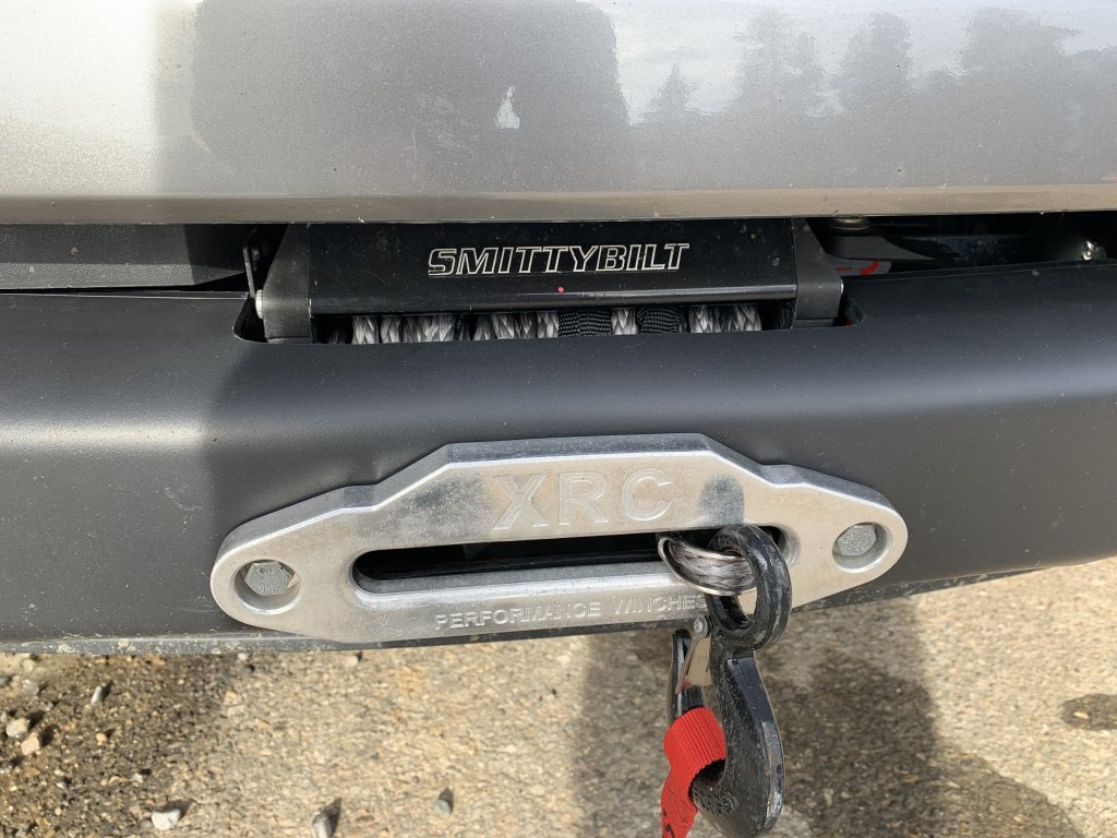

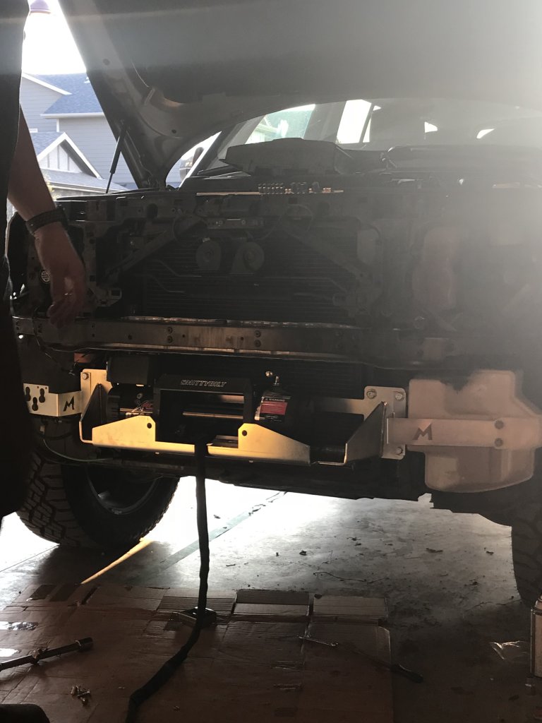

Could you give us a location of the source for this setup - I myself would like to do this to my LR3
sure.
I got the Terrafirma winch mount from Lk8 in NY. (Hope your experience is better than mine was). I’m pretty sure Terrafirma 4x4 have other stockists though.
The winch I found at 4wheelparts.
My battery isolation was from Amazon. There’s lots available, pick whichever suits your needs.
I’d recommend a small tool like a dremmell for the bumper cutting. Get lots of blades for it to, because it took a lot of cutting to get the backing trimmed to a good fit, although the hole in the bumper itself was quick and easy.
