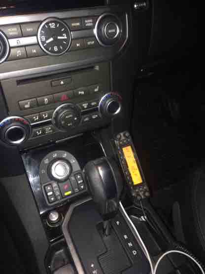

The local plastics place (TAP Plastics) made me a wedge of plastic to angle the faceplate towards the driver and again I used my double sided tape to tape the wedge to the trim and the radio to the wedge.

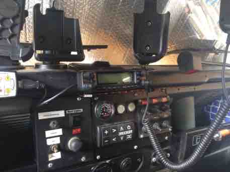

The radio in the 110

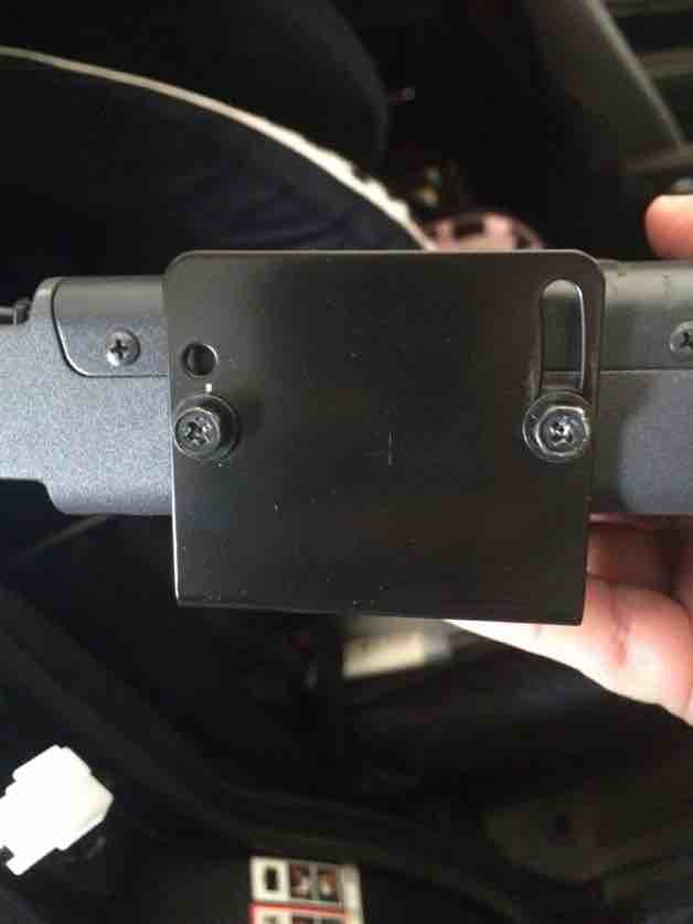

Here is the bracket mod. Just have to drill another hole which moves the radio down. ImageUploadedByTapatalk1433998562.231705.jpg

OK - I think I get it now - the head unit is to the right of the console and the antennae connection is under the seat.

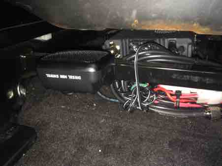

Correct. Sorry for the late reply I was playing in the backcountry of Oregon. Radio worked well but was too quiet. I bought an external speaker at a truck stop and all is good. Volume is at 1/4-1/3 max and I can hear it well. I used double sided tape to stick the speaker to the cross bar under the seat. ImageUploadedByTapatalk1434897732.137956.jpg
Sorry I forgot to take a pic of the plastic wedge I used to angle the faceplate. Dimensions are 4 in long, 1 inch wide and 1/2 inch high angled down to close to zero.

As for the mic, the face plate is easy to use in this location but once the freq is set I use the mic. No extra long cord needed. I do use a retractable mic holder in the 110 and will probably be getting one for the LR4. There is a lot of clutter in the center console with phones and other devices/wires
