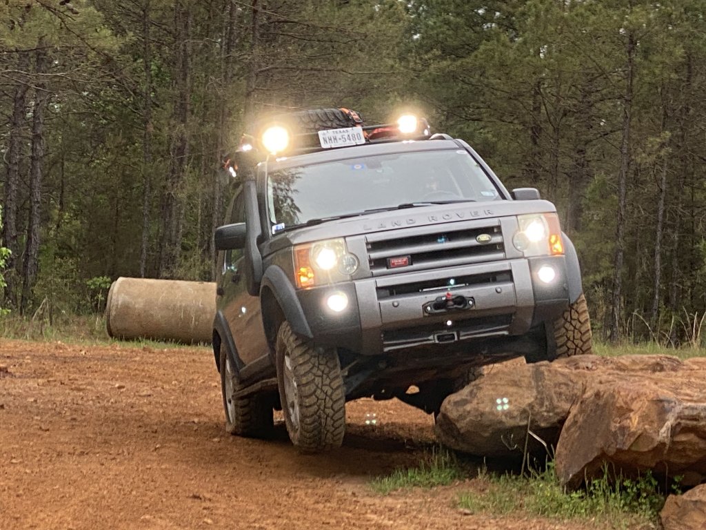

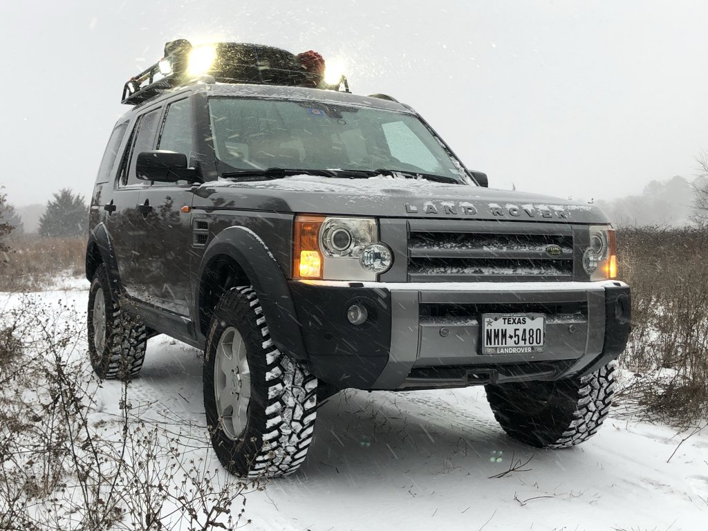

I’m running 275/70 18’s (general X3’s) on my LR3 and find a sweet spot on road about 40psi all around with better mileage than even at 38, and not much change in ride. Then off road (I love rocks) I’m really comfortable at 22. 18 was too low. 25 still too stiff.
