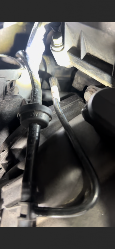

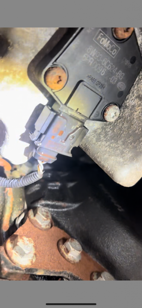

A heater hose or something behind the intake is leaking coolant right into the harness of the EXTERNAL oil level sensor.
Add this to the list with pvc, vacuum pump, and crossover pipes.

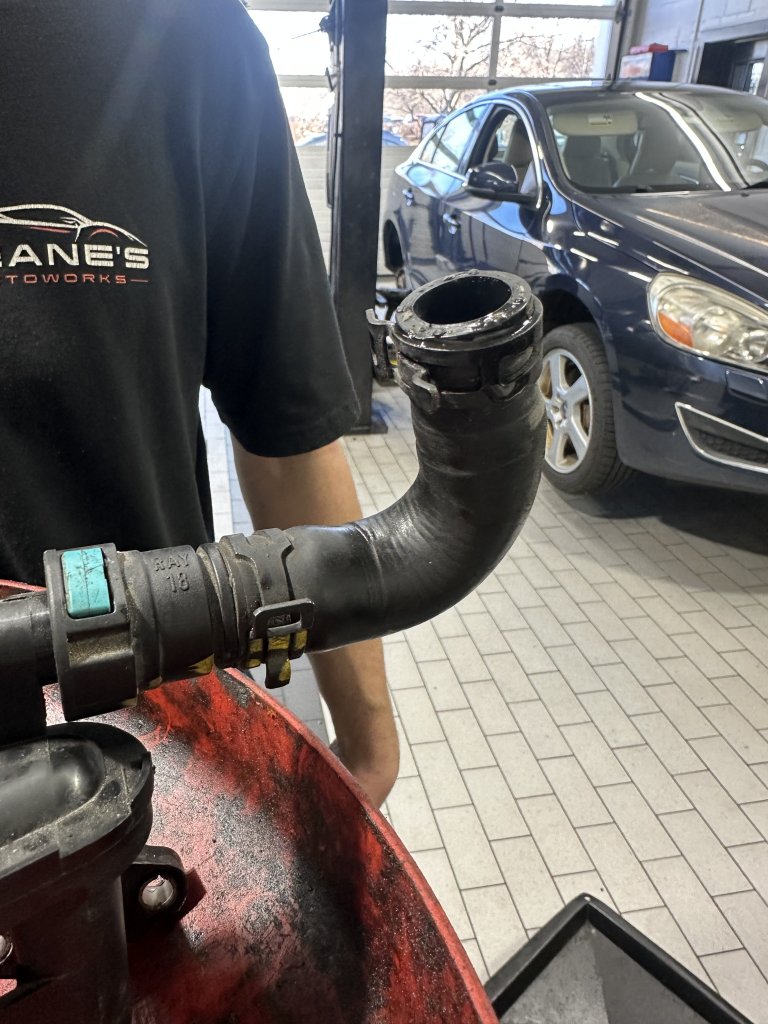

No the rear crossover was just replaced- it was a hose/clamp
