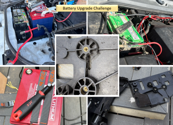

I got a different form factor to work in my 2012 LR4.
But charging profiles with OEM alternator is problematic.
Need technical advice, please.
Local mechanics not helpful. ChatGPT offers a 250A high-output Alternator from Nations - but waiting on feedback from bolting and fitting. Wakespeed WS500 Pro Alternator Regulator?
Went from a 94R/H7 to GRP 24 DL+12V-135Ah DP.
