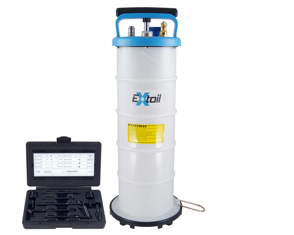

What filling tool do folks recommend to hook into the fill port? My idea of siphoning old fluid out does not work at all as I cannot insert the nylon tube from my extractor more than a half inch or so. I had hoped to avoid the mess of draining right over the exhaust pipe. I have given up on that idea. Now I need a proper fill tube, probably hook-shaped but rather small to adapt to the the hole without interfering with the valve body.I do not see a tool like that on anyones list.
gsxr
May 8, 2017
782
367
Big Sky Country

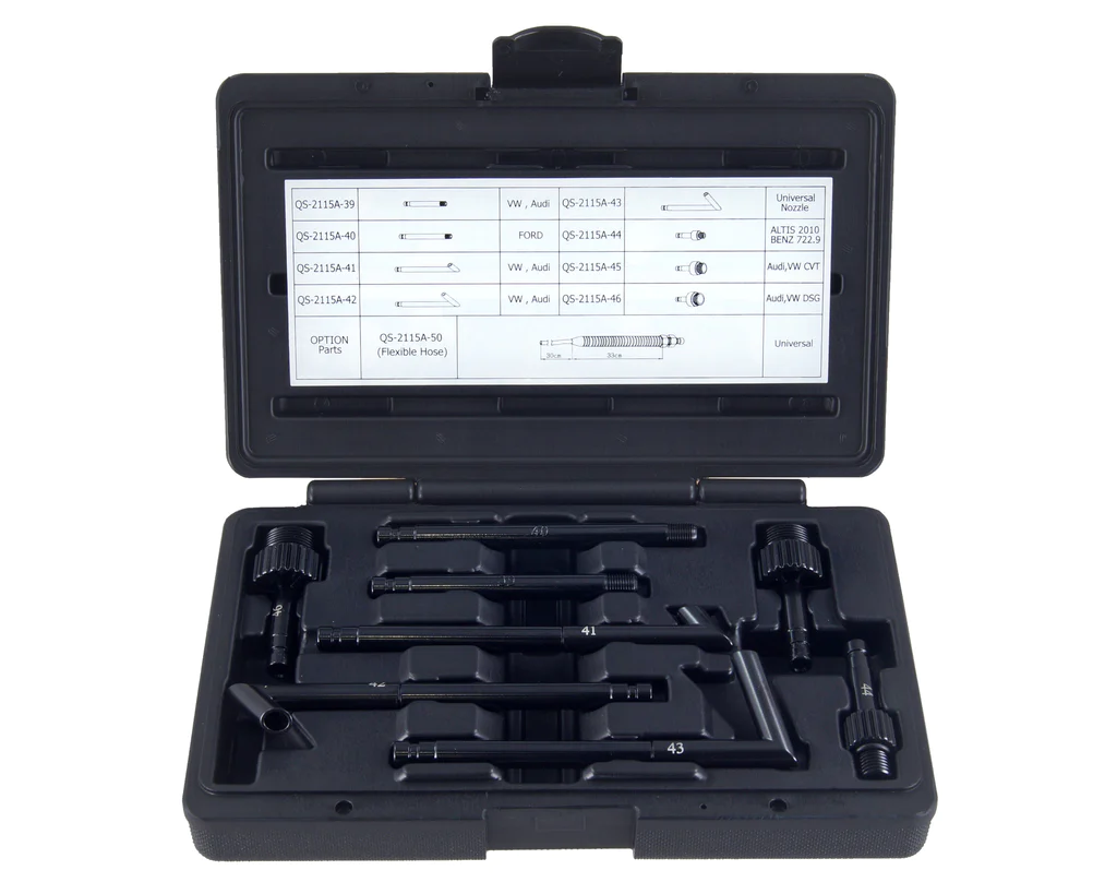

Most filler pumps include a selection of adapter tubes. If you don't have a pump, you'll need to buy one, or fabricate something. I have the Extoil unit shown below, there are others with a similar design. Pretty sure I used adapter tube #43 or #43:
Lgibson
Dec 25, 2014
322
13
Much appreciated! I bought a Holt extractor/filler at HF. Not quite as nice as yours and no tools supplied. I may be able to use one of the Assenmacher nozzles I bought for my Aisins. Was just thinking such a famous tranny as the ZF 8 speed might have a dedicated filler nozzle.
