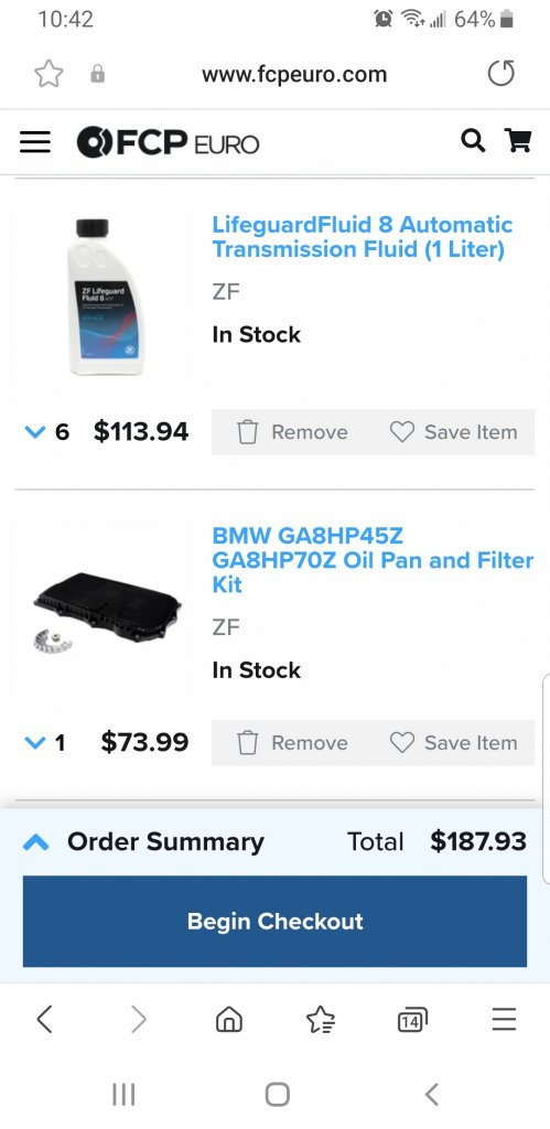

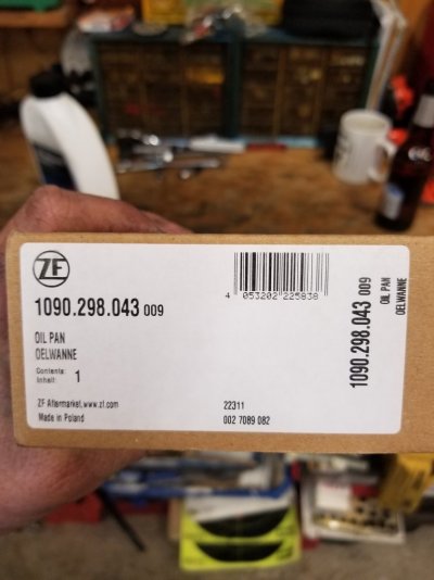

LR4 just hit 50k. Doing the diffs, tc and trans service. 16' with ZF8HP trans. Here's the best price I could find on ZF pan and fluid. Don't mind the BMW part number. It's the same for the LR4.
I'd 100% get it from FCP Euro.

FCP has lifetime warranty on everything, including the ATF and filters. (!!) Think this was mentioned somewhere previously in this 23-page thread? Great vendor, I buy from them as well.

Is it possible we have driven the price of this kit up to $206.97 in just a few days?

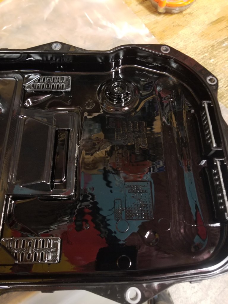

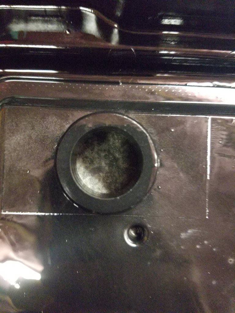

Ok all done. Diffs and TC oil looked great. Diffs were still yellow amber color. Normal mush on plug magnets. Mobil 1 75w90 Syn. TC got Royal Purple Synchromax.
Trans service about 4 hrs or 3 beer job. Fluid was still green, just darker than new stuff. Drained out 4.5 qts total. Refillled with roughly same amount. Trans temp was 105* when it started to drain out fill hole.
Hardly any residue and just a very very thin layer of metal on pan magnets. You can still see some white on filter looking inside. Honestly I could have just did a drain/refill and been fine.
Plan to do drain/refills every 25k miles going forward. Maybe change pan/filter in another 100k if we make it there.
Wife's DD. Towed our boat a dozen times during the 50k.

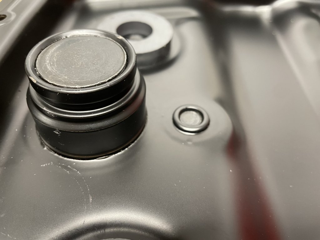

After. Also, which of the two plugs on the metal pan is the drain? There's a big plug and a smaller one. I meant to ask and don't recall which is which.
JDiehl
Jan 22, 2012
63
16
Kansas

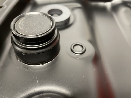

On my pan from FCP the smaller plug will get more of a drain.
