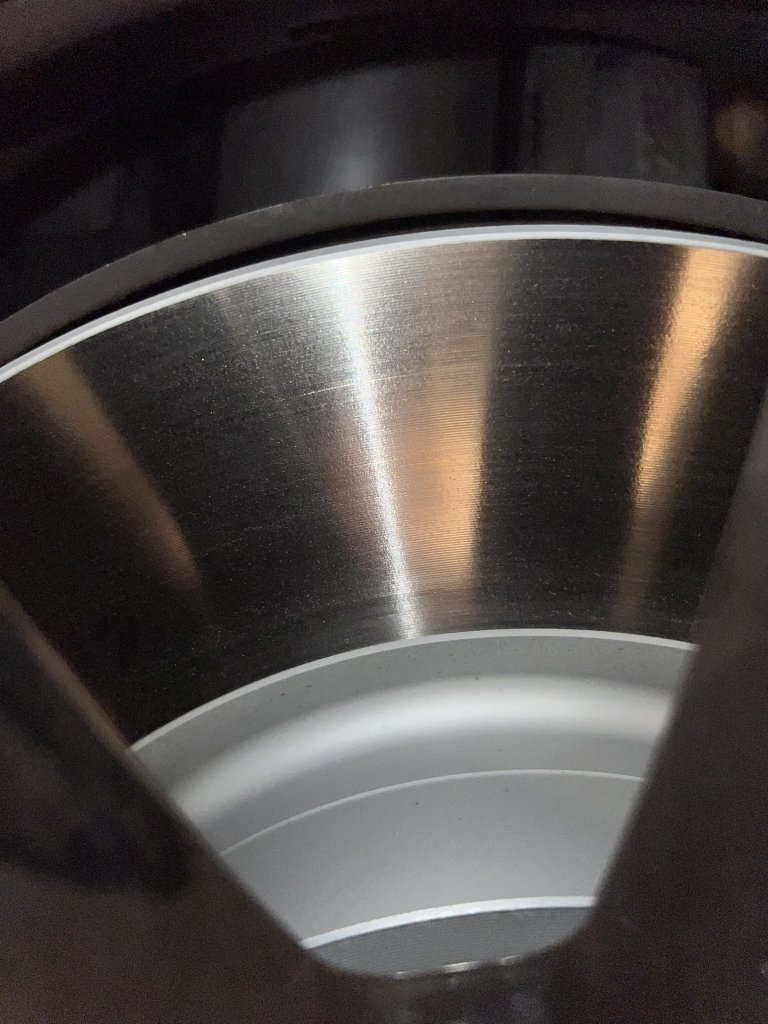

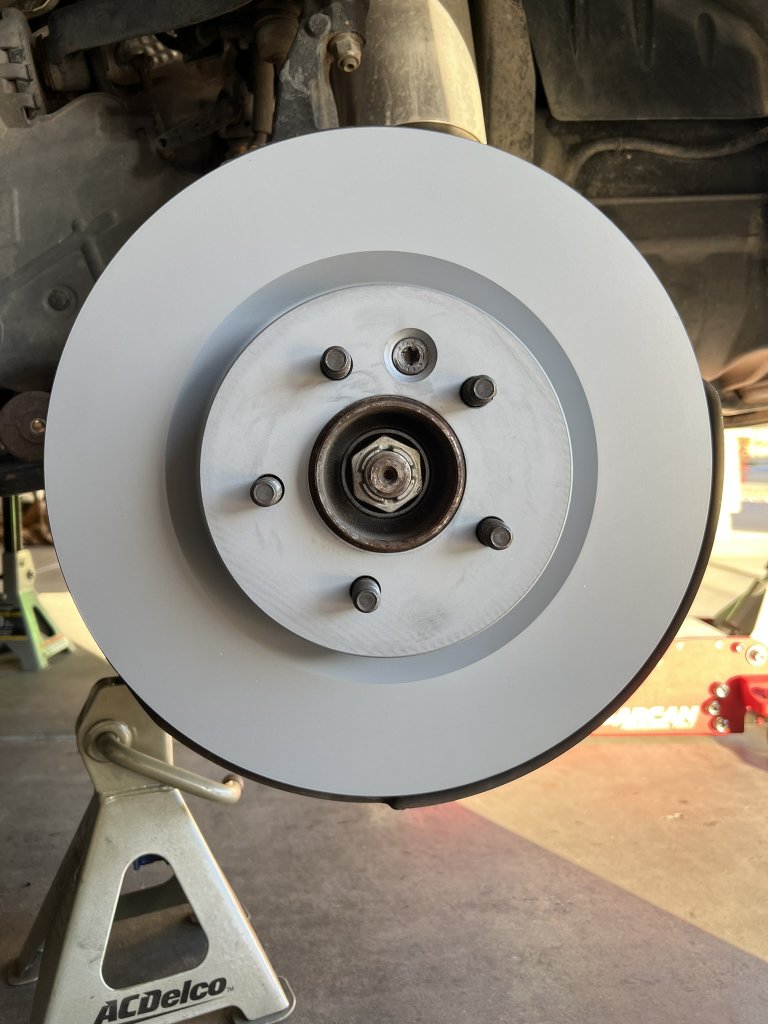

Why would it be good to coat rotors with a soft metal like zinc?
Like ryanjl said, helps prevent rust/corrosion.
The entire rotor is coated, so when you install them they look weird until you wear off the coating (5-10 stops in my neighborhood and it was gone) Brakes felt awful when the coating was wearing off, but it went away very fast (The instructions tell you how to wear the coating off)
It's also nice because assuming you don't get any grease on the zinc you don't have to spray it down with brake cleaner.
Before
After
