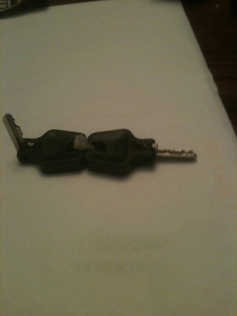

Mine keys are black and I was told that the hitch was just installed last summer. I haven't even messed with it yet to try the keys. From what I've seen there may be other parts stored in the compartment in the rear of the vehicle.
