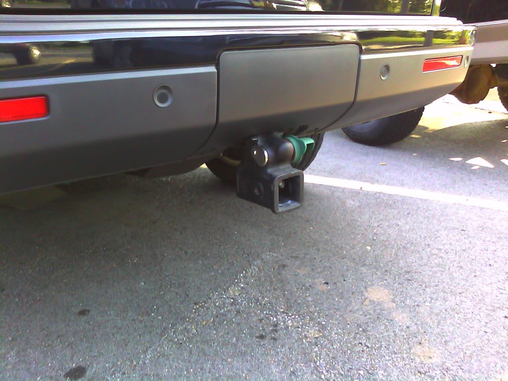

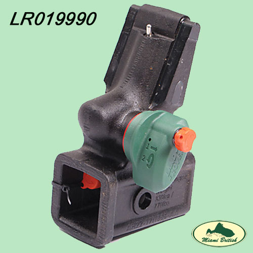

You can find the hitch receivers on eBay and the like, the only problem being you do not know their providence.
The key thing is the bit that retains the receiver to the vehicle.
There were a three variations of the locking bit; the green one with the red key is the newest and probably what to look for if buying used. First there was a black key, then an orange, and finally the red; each key indicative of a changed and we hope presume improved design.
You might also consider purchasing the shorter one, the LR4 model as for certain, it has the newer locking bits. Also do not lose the key or for certain, make a duplicate.

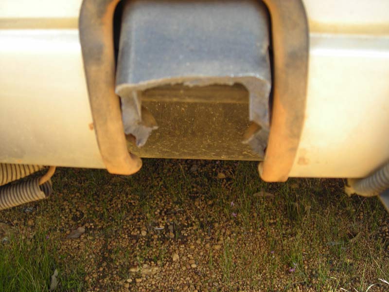

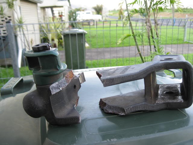

The broken receiver on the left is one of the longer LR types - breakage is not common.
The broken receiver on the right is from a Prado, also not typical.
In both cases, I do not know what the owners did but it suggests Toyota is not perfection either.

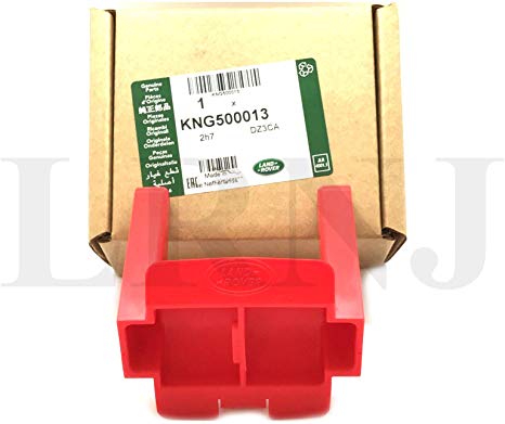

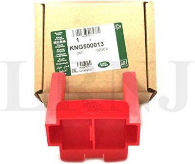

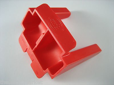

I guess I'm a purist. My hitch receiver is in my shed and my amber cover-thingee is in that rectangular hole.
bbyer
Aug 15, 2008
899
153
Alberta
I guess that would be this. The plug is characteristic of the detail LR does put into their vehicles.
