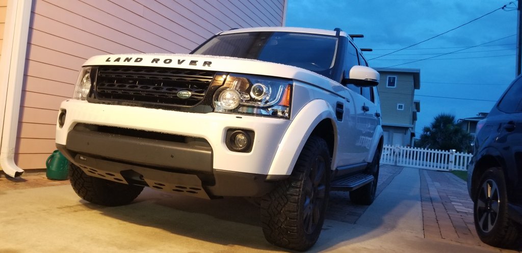

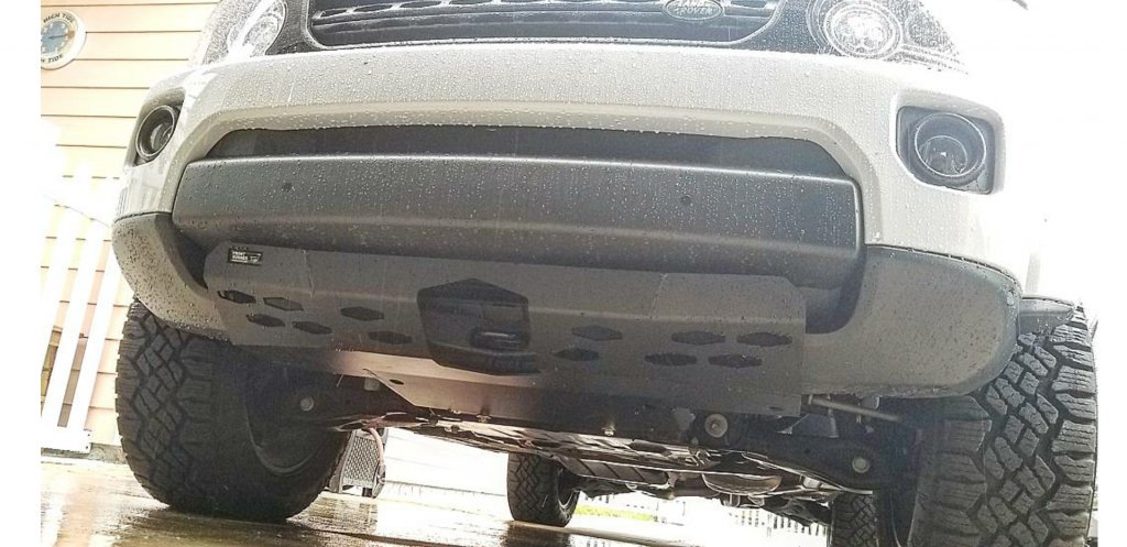

Pulled the trigger on the front runner front skid, I really like it. Very clean welds, I like that it's already powder coated and it's stainless steel. It was super easy to put on...just bolts on, took 15 minutes to install. I plan on having the rest of the pieces fabricated via my father's machine shop

Does it maintain the factory skid under the engine?
