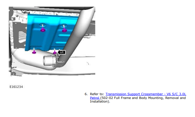

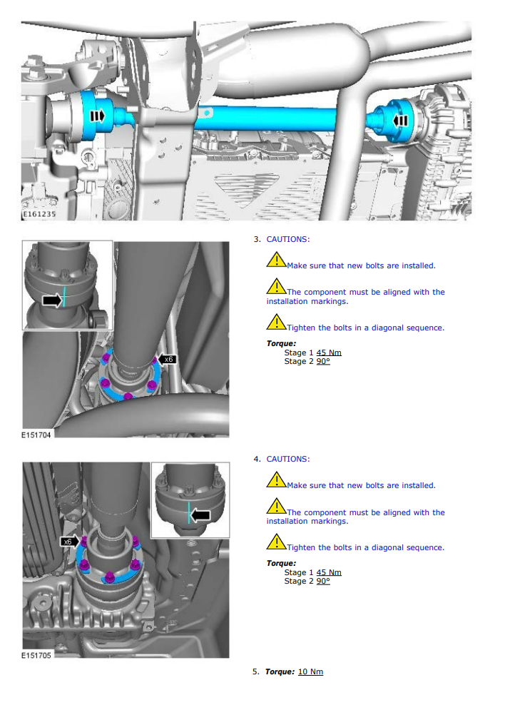

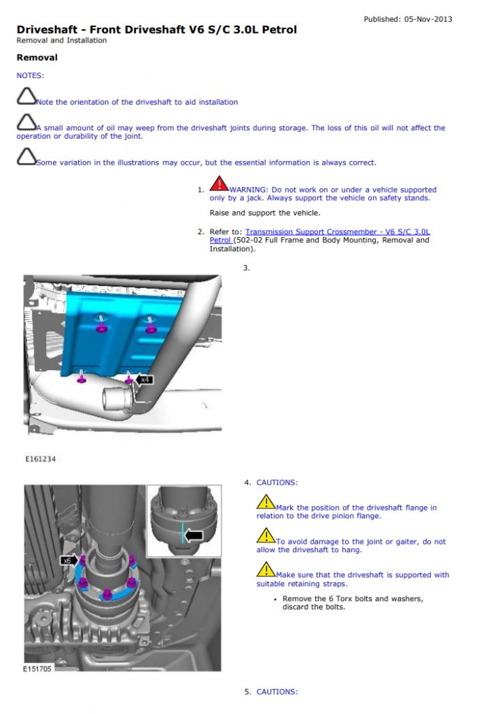

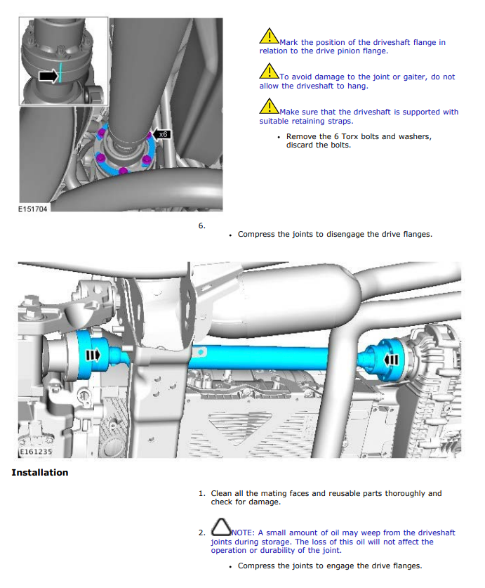

There's a section in the workshop manual that describes the sequence and torques and so forth. The shaft seems to be telescoping, so you undo the CV joints at either end, compress to release from the diff, then remove from the transfer case. The transmission cross member is documented as needing to come out, along with the transmission heat shield. Bolts are torque-to-yield, so must be replaced.
