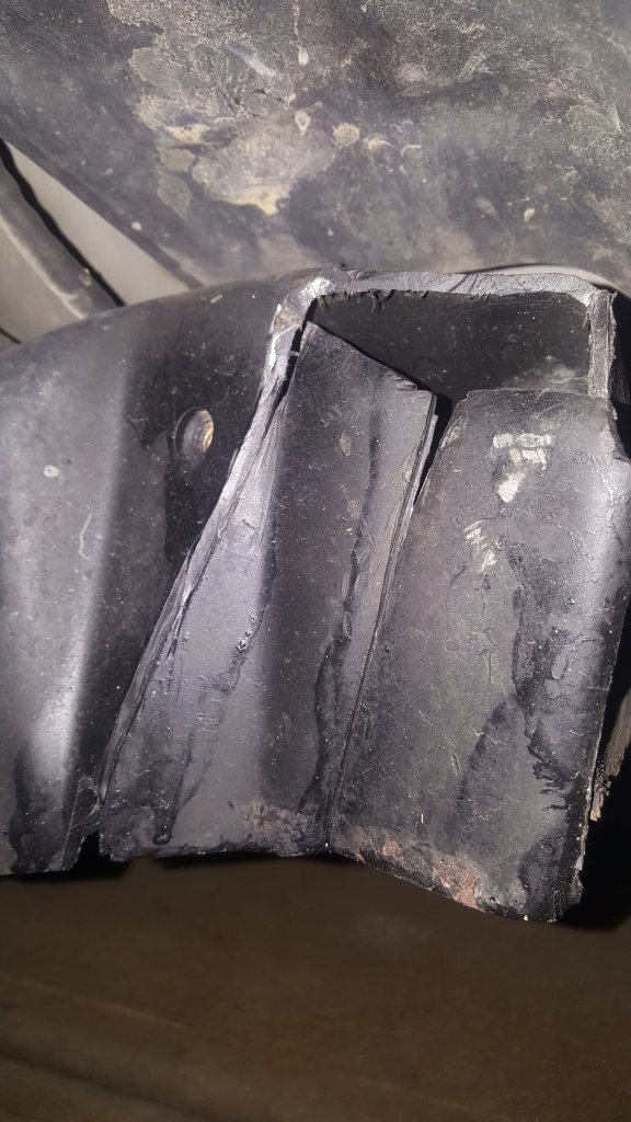

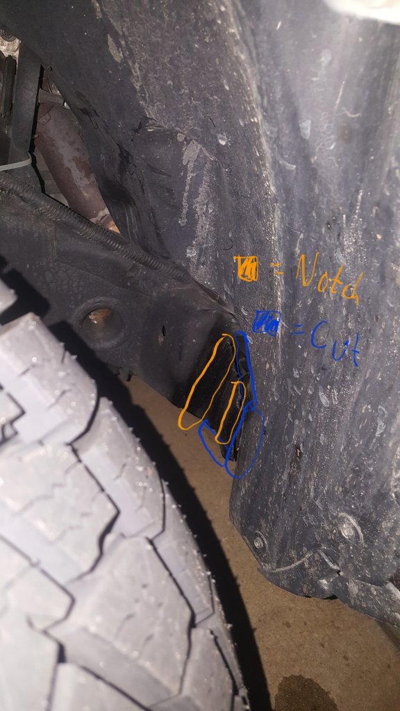

Hey mate any chance you have photos of which part you trimmed and how much ?
These are the only pics I have on my phone. You can do what the OP did: cut off frame horns and weld a blank back on. Or, be lazy like me and notch, remove some bulk, and bend / hammer the frame horns into the frame.
