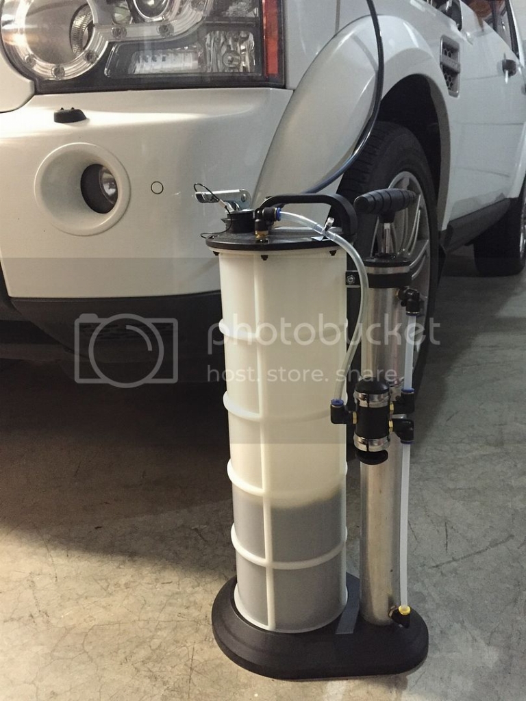

Did the first oil change on my LR4 since purchase. 62k on the clock. Dealer had changed at 55k.
A few interesting observations. I also purchased the Mityvac 7201. My first experience was fair. Although it is simpler in nature Im not feeling as confident with that system. I had to keep pumping the unit quiet a bit to keep the flow up. This could be due to cold oil but I wouldn't think it would make that much of a difference.
What also concerns me is that the amount of oil extracted would only go to the 7 liter mark. When I ended up refilling the engine I stopped at 6 and 7 to check the engine but the display always read too low. So I ended up just going all the way up to 8 liters for a refill. I guess my oil level could have been low from the dealer change or its burning a bit... I'll report back during my next change.
FWIW I extracted warm oil when I used the MityVac for the first time and it bingo'ed out right at 8L. After replacing the full amount of oil I had trouble getting the digital dipstick to register a full load but then came back and checked it about 10 min later and it was spot on.
Actually, it makes a pretty big difference if you will be vacuuming it out. If the engine is cold, run it on idle for about 10 minutes, then turn it off and let it rest for another 10 to allow the warmed up oil to drip and collect in the drain pan. And don't forget to loosen the filter cartridge 4 or 5 turns before you start vacuuming, you'd be surprised at how much used motor oil that cartridge will retain if you don't do that.
