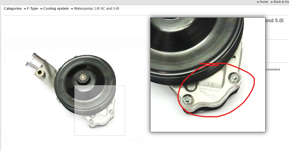

Not mentioned previously, but I purchased the new version of the water pump, oil cooler pipe and o-ring... all genuine LR parts.
1,403
Got a cat stamped on it. Then you know you have OE

I would get some new coolant pipes. Probably a manufacturing defect on yours.
Well, we are about to find out. Just installed a new front pipe I bought from the dealership last night. Currently in the bleed process, and driving short distances to make sure it is not leaking.
Before replacing the pipe, I did a pressure test on it, and my endoscope showed coolant slowly leaking from where the pipe fits into the block. So, I am hoping that the new OEM pipe will provide a better fit/seal. The top mounting hole certainly lined up better than the last one... no washers needed. Cautiously optimistic this saga is over.
Lesson learned: Double check that you are purchasing oem parts.
Was the previous pipe from Atlantic British visibly different, i.e. lacking JLR or FoMoCo markings on it?
When buying parts from aftermarket vendors you must be VERY careful that they aren't selling aftermarket copies when you think you are receiving OE/Genuine JLR parts.
Also keep in mind that OEM is not the same as OE... some vendors have misleading marketing copy. The OE part is Genuine JLR, with a JLR package/box/label, what the dealer sells. OEM is aftermarket that should be manufactured by the same company as the OE part. OEM is sometimes the same as OE but without the Genuine box/label, but not alway; in some cases the OEM part may be different/inferior.
I detest vendors that don't make this explicitly clear on their websites. If the price seems too good to be true, it probably is.
