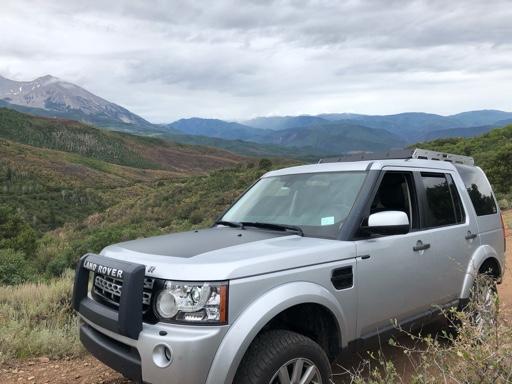

I have a 2013 LR4 HSE and have made many trips to the mountains in the summer and winter, no problems AT ALL, but if chains are required no matter what, that just sucks! Just got back from Crystal, CO and did some rock crawling in Carbondale, CO. This vehicle continues to impress me! All I’ve done is give it small DIY lift by modifying the existing rods ($5) which isn’t really needed and built a roof rack for it. It pulls my boat, hauls kids and bikes all and rides like a Cadillac...LOVE IT! Might get a metal rear bumper soon and hidden winch.
