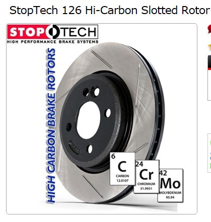

Just FYI, the EBC rotors that I ordered came in and did not fit my V6 LR3 as they were too big. I sent them back but decided to keep the EBC Green Stuff brake pads. I also decided to go with a better rotor option and went with these. I will let you know how the combination does, once I put some miles on them.

odd, did you find out if there are different v6 sizes? too big would mean wrong part number sent, not something about the manufacturing necessarily.
Did you get the stoptech direct or what source?

It is a bit complicated but I purchased the EBC rotors through TH Motorsports and they were direct shipped from EBC. TH Motorsports' website said they would fit but they didn't. I received 13.3 in. rotors, part number GD1339, which seem to be for the V8 model. My V6 LR3 requires a smaller 317mm (12.48 in.) rotor. I contacted EBC directly and they told me the part number that I should have been sold was GD1372. However this part number is not sold in the US, only the UK. Not sure if this is the same for everyone because the folks at EBC seemed a bit confused, after providing them with my VIN, at me living in the US and purchasing my vehicle in the US (Maryland). They believe it possibly came from Canada.
I purchased the StopTech rotors through buybrakes.com.

I just talked with Lucky8 and they actually ordered mine direct from UK EBC and confirmed that these are for the NAS spec 4.0 V6. You must've gotten the v8's by accident as that size sounds like the v8 number i recall seeing.
Keep in mind there is actually the v6 tdi which uses larger rotors than our old gas v6. I think you can read about these variations on the mudtech website too.
