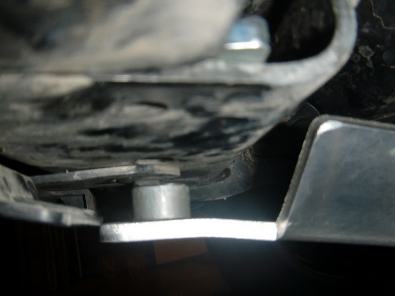

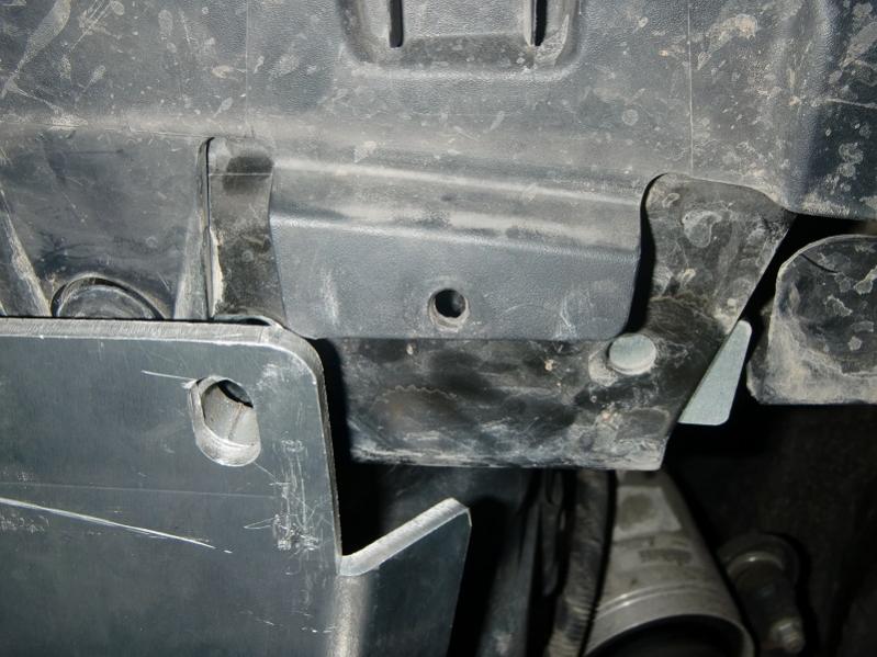

TLB, how'd you do? Probably too late to be of any help now, but I was going to suggest you zoom into the last photo of my installed plate (see page 3) as the location of that spacer and front plate bolt is visible. Anyway, looking forward to the installed photos.
Ivan, I can measure it for you on Monday when I get my car back from the dealer. You referring to the strip of foam on the inner edge of the front plate, right?
Hi Umberto,

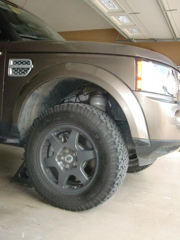

I wish I took a very close look at this picture yesterday when I was assembling the skid plate.
Anyway, it is done. Like you said, it was easy once you figured out how to do this. Installation instructions would save lots of time and language kids should not listen to.
For sure , Asfir plate can not be mounted with OE plate in place. On the other hand the small OE plate can be left in place ( after removing the big OE plate bolts go back to secure the back of small pate).
The bars/spacer were the worst to figure out where and how to place them. On the diagram, from asfir they point straight to the front, but in reality after inserting them into a "frame" ( this took me few hours ) they look at each other at 90* to long axis of the truck.
Thanks for or your help :hello:
LR4 in super extended mode
My" favorite" part of the installation a bar/ spacer :help::help:

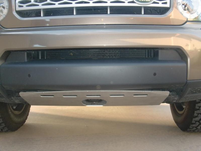

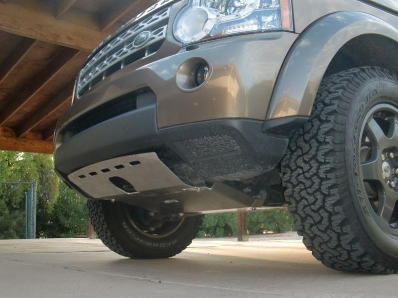

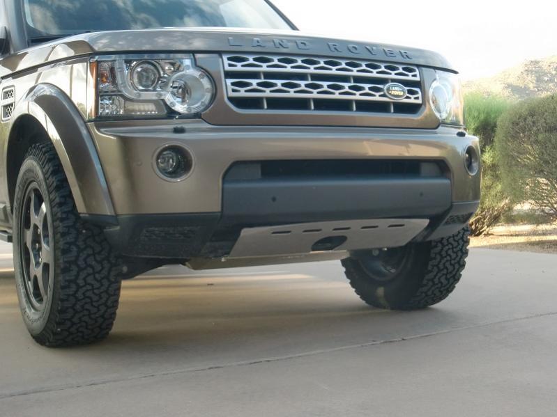

And few final pictures. I decided to save money and not powder coat the plates. Black would look better but with a silver grill on the truck and a silver skid plate it is still OK.
In few weeks my t-case and fuel tank tactical rover plates should arrive and I will be done with mods. Hmmm, a spare tire swing away carrier would be nice :smile::smile: , maybe in the future.
Good looking rig!
