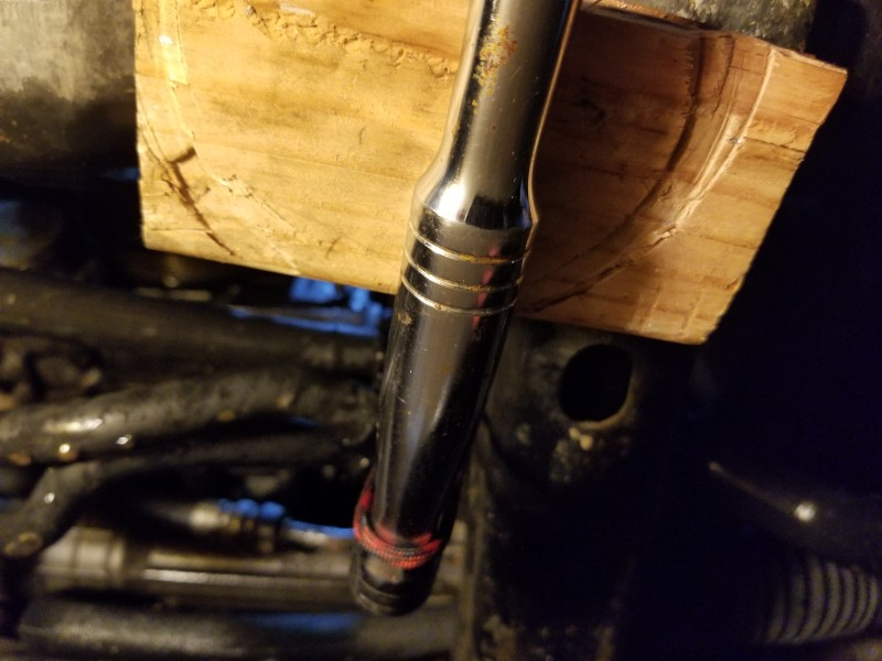

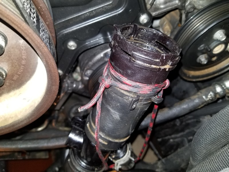

There's a metal retaining clip that holds the plastic coupling to the lower thermostat, just pop it out with a flat head screwdriver. With the thermostat bolted down in place, I used a single paracord and tied constrictor knot around the top side of the lower tube and with the other end another constrictor knot on the opposite side. This leaves a loop hanging just below the bottom of the frame, and I used my breaker bar for leverage pulling down on the paracord's loop. The constrictor knots on each side evenly pulls the pipe out of the thermostat.
