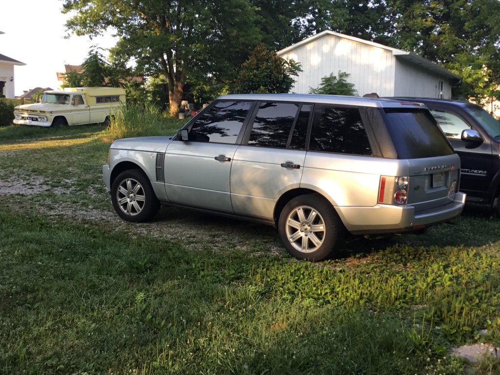

I too am curious about retaining my 2008 Range Rover with 112,400 miles. Bought it used six years ago with 84,000 miles. Previously owned Lexus 470 and the Rover is so much nicer to drive so sold the Lexus. Joined this forum for info on what to expect and how others have solved repairs and maintenance.
so far one road trip brake down due to alternator. Transmission serviced myself as well as brakes and rotors. Looking into the tilt wheel issue and hope to fix. Driver front CV boot torn and assume best to replace entire unit due to miles (no symptoms yet but figure boot replacement not adequate).
Assuming if maintenance is continued and I watch for other repairs, is it worth keeping or let it go?
