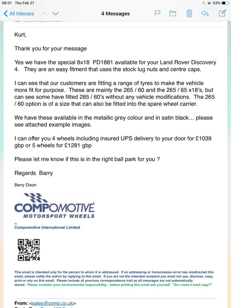

This is the quote.
1281 pounds = $2186
5x KO2 @ $352 = $1760
5x sensors, seals, balancing, fitting= $250
Total = $4196 +GST = $4400
Will also need to get the camber changed as well. Advice from 25 year Land Rover mechanic
Or I buy 5x Atturo or duratec for 1400 fitted until I can save 5k
1,858
Save 5K? Where are you getting that? Even using your own numbers, you'll have to do some of the same things regardless, and you're not even considering the cost of the Atturos.
1281 GBP is around $1,670 USD. EDIT: I guess you must be in Canada. Regardless, your logic is off.
The BF Goodrich tire is night and day better than the Atturos. That said, you can find cheaper tires than the BFG that will still be better than the stock size Atturos. Just so long as it's an E-rated tire, you're well ahead of the Atturos.
You can reuse your current sensors.
You'll have to do balancing no matter what tire you buy.
The camber thing is questionable. But you should get a lifetime alignment package from some shop regardless of any tire/wheel decision you make.
