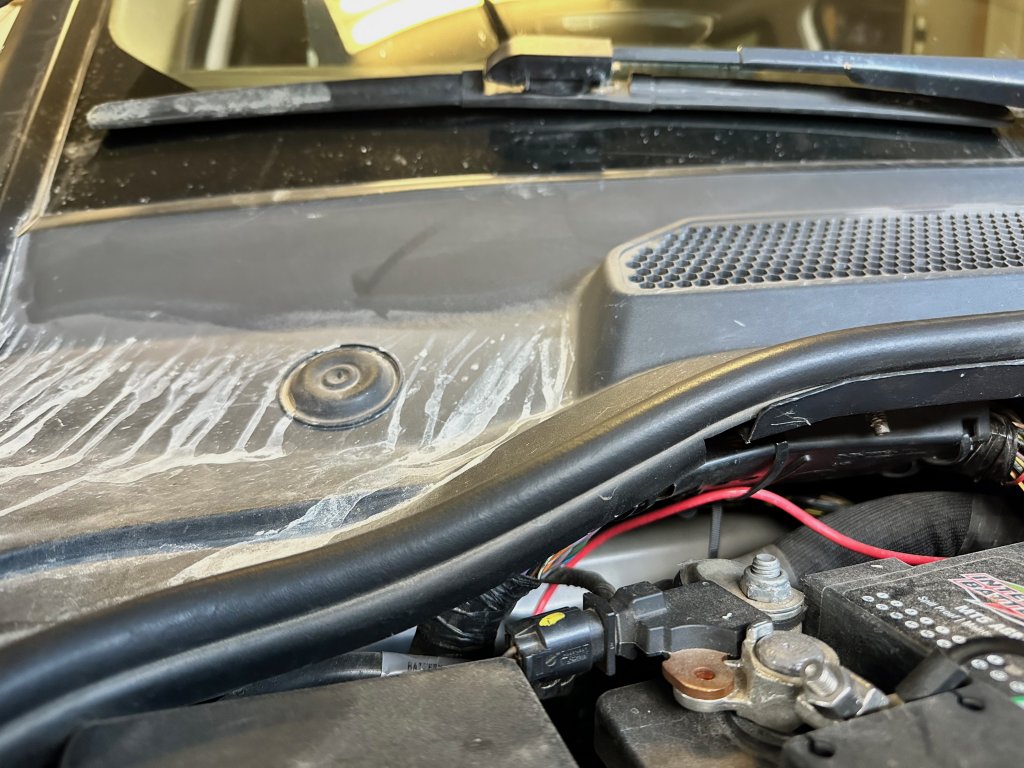

Interesting. I'm not sure whether the new version is any different. It looks like that image is taken with the whole cowl removed? This is all I can see:
douglastic
Jan 26, 2016
163
51
correct, remove cowl to get access - the problem is underneath it
also unfortunately, I think the a-pillars must be removed first in order to then remove the cowl
so have new clips on hand
