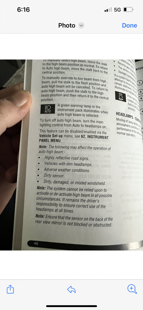

It's very easy to understand, if your interior mirror looks like that – you have it.
If not – you can install it :) need ah42-17e678-ad with new housing and change 3 lines in CCF and enable HBA in menu.
uL-xpZVbhUeMDwcMpjLEiZ4sLJM-1920.jpg VerzG8Mpb5WIYFlRQjqN3mhE-oA-1920.jpg CwMoAL4hzS2NjnxqcKlEn3UVAvU-1920.jpg
Here's how it works after retrofit
