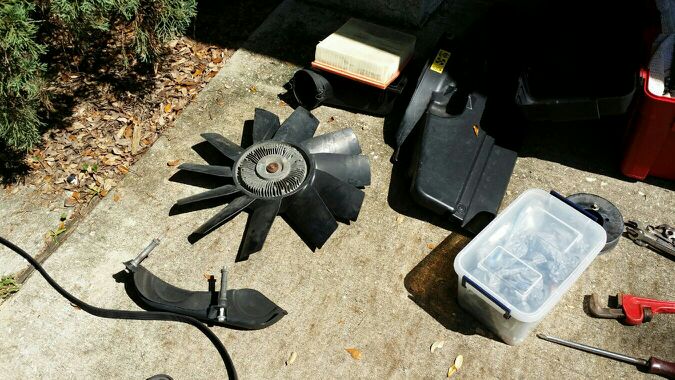

Well it must be love LOL sigh 1st week and a water pump ☺

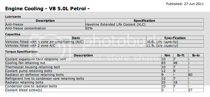

Water pump, remember only 20ft lbs of torque or it will leak internally and hydrolock your engine.
Not sure where those specs came from... the D1/D2 is either a 3.9/4.0/4.6 all variants of the same engine not a 5.0. And yes 20 ft lbs torque...
