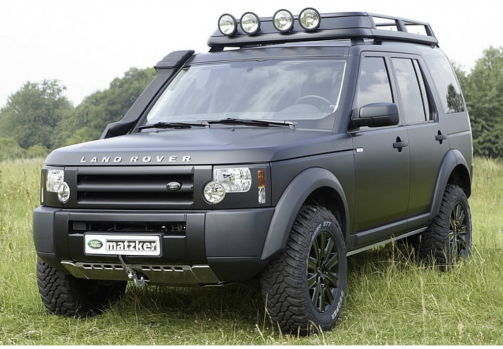

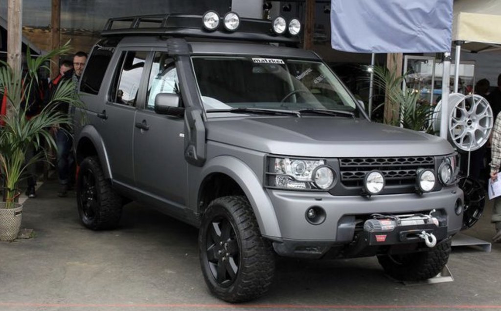

Can anyone tell me what size tires and rims these are and if you need a lift kit for them? I am looking for the largest tires with the least amount of work. I am trying to replicate one of these two LR4’s.
Those are two pretty different setups, notice how much more tire sidewall the second one has?
The black one looks to have the OEM 10 spoke wheels in black (perhaps painted black by the owner?), with Cooper Discoverer STT tires, and I'd estimate they're 32" and he lifted the truck at least 2-2.5" over factory to make them fit.
