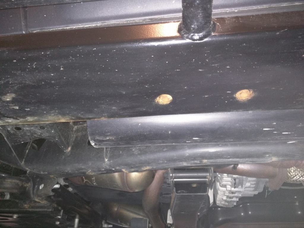

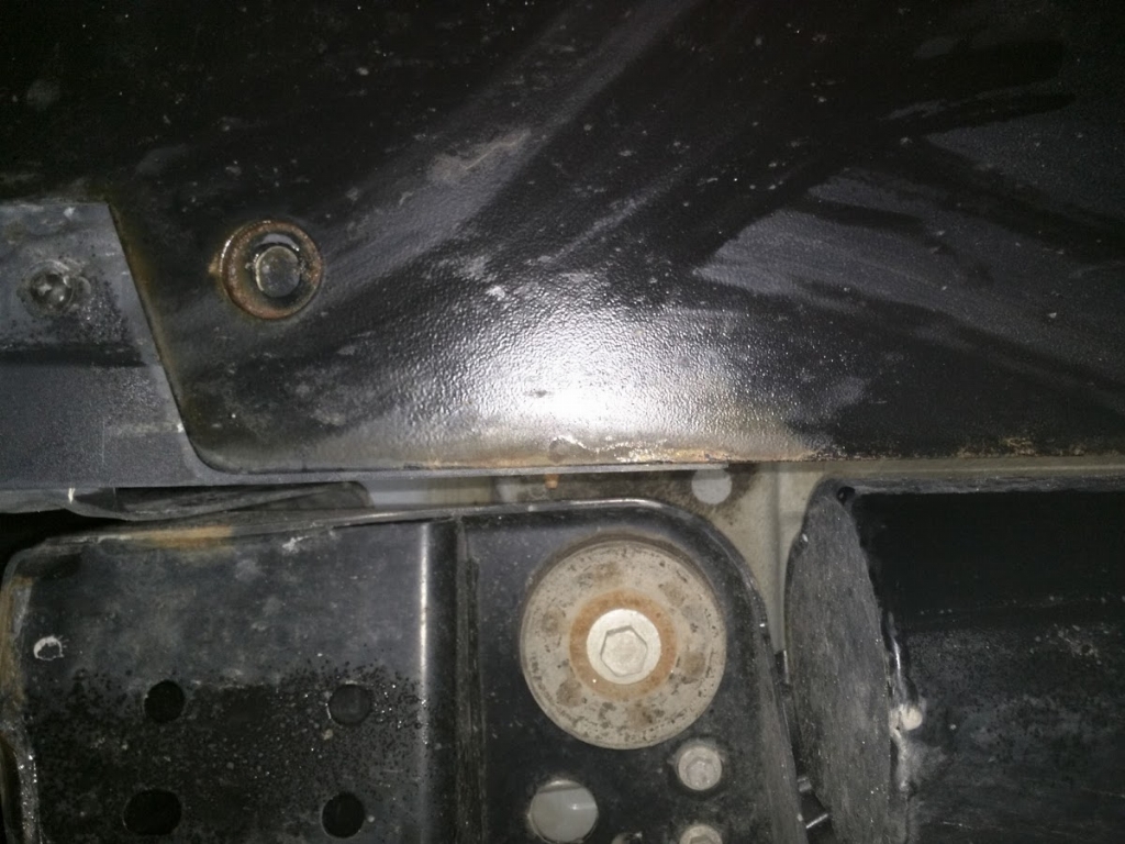

I live in Iowa. My voyager sliders rusted like mad. I was ******. I called Voyager and they had me ship them back (my cost) and they stripped them down and re-coated them. They said they put more than twice the zinc coating on this time and made the powdercoat thicker. I can't tell the difference.
So, after another iowa winter (Which they claim can't be worse than being on the coast of florida, where they make them)... they look better. Not perfect, but much improved.
These shots are from today, i just went out and took them.
So, im conflicted. I like these sliders. They are not the largest or heaviest (a good thing for me) but they do have coating issues. I just plan on having them re-done locally next time they need it.
I also had the ladder redone at the same time. It is in good shape. The rack has a few spots also, but it stays out of the salt more. I can easily sand and repaint little spots on the rack myself.
The stuff is steel.. so I guess we can expect some rust. Anywhere that gets ground on a rock or something is going to rust, and these sliders sit in the muck and get hit with every little bit of sand/salt on the road from the tires... so ya.
Take the good with the bad I guess.

When I called them after a few months they offered me the same thing. I said thanks but no thanks. It costs A LOT to ship these monstrous things. I rather put the $ towards a better coating.
I'm a mechanical design engineer and have access to a pretty good plating house nearby that we use for work. Zinc plating is just not the best approach for this. Plating is good against the environment, but not against impact. Once a stone chip pierces through the coating it's just a matter of time.
The fact that their process allows for more plating tells you it's sucky to start with.
I was going to hot-dip galvanize with a super-thick layer and then powder coat. But then I figured that truck liners get the hell beaten out of them for years and it holds up. In part because the coating is flexible, so it absorbs chip impacts. Bonus: it's grippy, which is good for steps. FYI, things do not adhere well to zinc plating, so you are better off finishing over bare metal or using a proper primer.
I'll give the steps a shot, if it holds, I will later treat the OEM ladder, which is holding up very well except at the seams. So for now, those minor spots along with spots on the undercarriage I will spot treat with a rust reformer/converter.

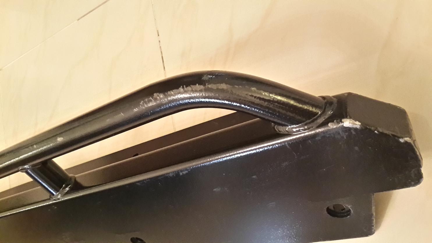

Exactly. I love the design, but mine were shipped poorly and were so scraped and beat up by the time they arrived that I had to send them off to get re-powder coated!!
Here is the pic, as they arrived:
