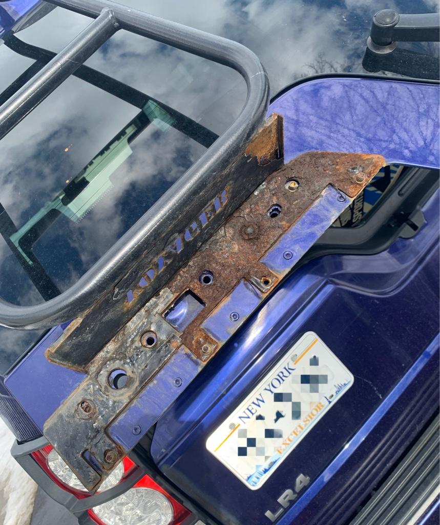

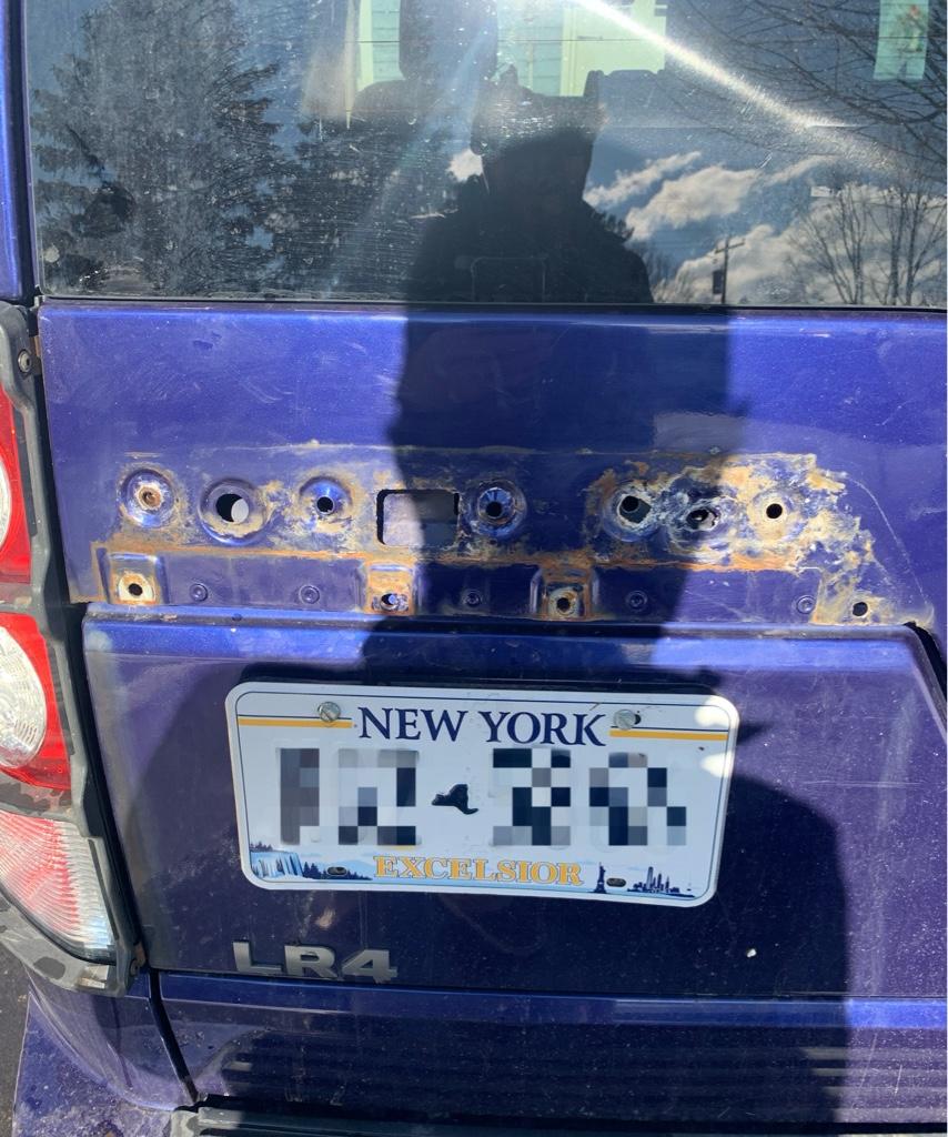

When I bought my LR4 I noticed some rust on the rear ladder for the voyager rack where it mounts under the lift gate switch housing. I just assumed I would take it off and Powdercoat it. Well it was a nice sunny day today and I thought I’d take it off, what a nightmare! The steel was rusted so bad that it was in rusted paper thin layers.... bolts and nut inserts on the lift gate switch housing are now broken. The lift gate is in bad shape, and i tried cleaning it up but it still needs some further attention. I am now left shaking my head trying to figure out where to go from here....
East coast winter and road salt suck.....

I originally was going to install one these when I lived in California and it would have probably been ok then. I am now on the east coast and would never do it for this very reason. Sorry, I would probably sand it down, apply some rust bonding agent, prime and paint.

I really like the look of the stock ladder position (regardless of whether the ladder is OEM or aftermarket). But I’ve seen enough images like this to worry about hidden rust. At least with the ladder I have mounted on the other side, I can see what’s going on at all the attachment points and can sleep at night. Sorry to see this.

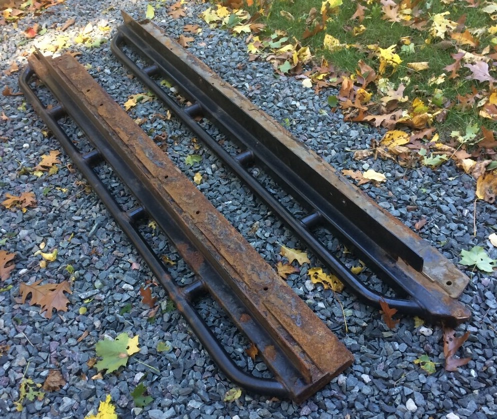

my voyager ladder from 2013 did the same and I sent it back to them to get it stripped and redone. It's been better this time around. My sliders from the same time did rust very badly. I think they just didn't (or still don't, not sure) do a very nice job with powder coat and didn't have enough zinc.
I still like the voyager sliders a lot though and the ladder. I might actually get another set of sliders soon because the t44 are a little overkill most of the time.

View attachment 12498 I mentioned this before but my experience with their steps/slides was awful. They would not stand behind their product (besides offering a similarly bad paint job with no offer to pick up the massive shipping charge) and I ended up removing them and effectively throwing them away. I had the area professionally fixed (primed/painted). Luckily for me it was an area not exposed/visible. Safe to say that I'd never get anything from them. The photo is from when I removed them after less than 3 years and well under 20k miles.
