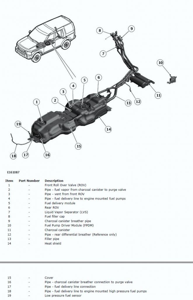

After filling it up and poking around a bit I have determined it is the fuel tank. There is a drain hole in the center bottom of the shroud, stick a finger up there and it’s gasoline on the loose..
Dealership dropped the tank and claims that the vehicle was "overfilled" and that the loose gasoline is coming from a vent pipe, that then drains out the shroud under the gas tank.
I know there are many components here - but anyone ever hear anything like this??

Have you had the recall done?
Also when you fill up, do you let the pump automatically click off, and then “top off”?
If you do top off, don’t. It could be related to your issue. It’s not good for the evap system.

Since my recall work was done, I have a consistent problem with the tank overflowing when I fill up. I put the pump lever-handle on the lowest automatic setting, and before it automatically shuts itself off, a bit of gasoline overflows from the fuel intake opening. Never used to happen before having work done on the recall issue.
