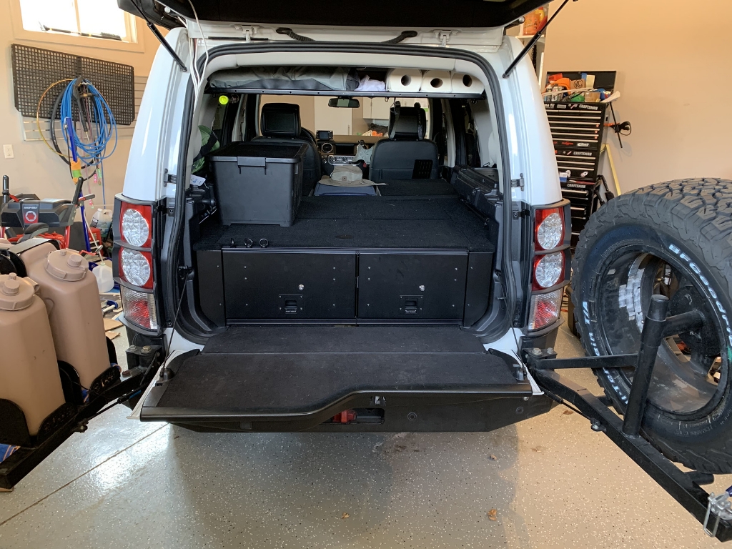

I personally have never seen a hitch mount (single point of contact) tire swing that didn't jiggle around like a fat guy off road. My Tactical 4x4 rear swing bumper may be heavy but its functional, doesn't obstruct my rear recovery point and the tire/jerrycans are rock solid. The LR4 drags *** off road and I definitely want that rear recovery point available.

I have buddies with the rigid and dirtcom tire carriers. Both are built very solid with a 2" receiver that you can hang a hitch shackle on.
I have the rhino ox hitch and this makes the tire carrier sit too high. The short oem hitch would do a lot better, BUT you lose a lot of departure angle.
I ended up going with the Terrafirma swing carrier. It's sometimes a pain to get something "quick" out of the back.
1,695
just because you can put a shackle on it doesn't make it a suitable recovery point. more of a tow point and only for straight level pulls. Just be careful with that.
