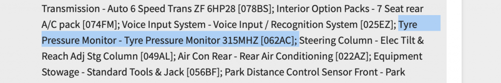

you can check TPMS frequency in vin decode. Here's mine 13MY
