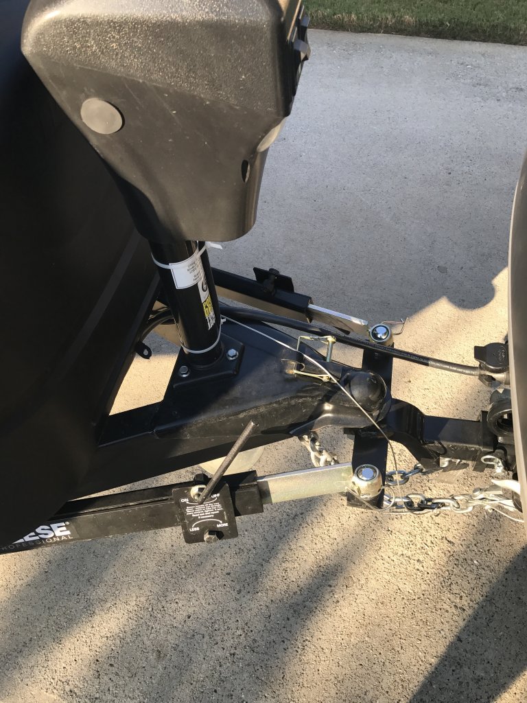

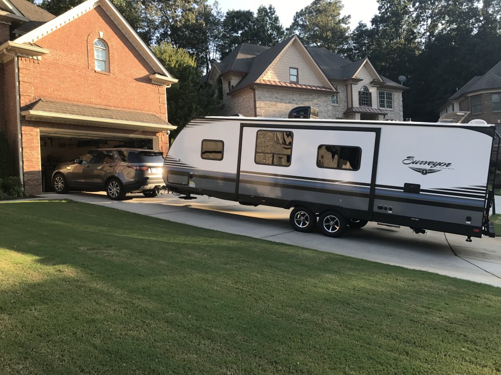

You’ll be fine with no WDH. It sits level and handles great. I pulled a 33’ trailer weighing 7000 lbs over 3000 miles to the Black Hills with no issues. I did put on a sway bar system recommended by my RV dealer. Total setup was like $150.

Th LR4 and D5 are designed to not need a WDH at all. They are NOT recommended, I would trust them on this one. You are just wasting money. I would also say you may create an issue using one in the event of a heavy evasive maneuver. The anti-sway bars would most likely screw with the calculations the car makes to auto steady the trailer already. Have you seen the video LR puts out on the subject? They are making some really heavy evasive/swerving maneuvers and the truck compensates fantastically. They are using a 2500-3000lb trailer and a roughly a 4000lb Defender loaded on top. So its top heavy and not perfectly balanced like a camping trailer would be.
EDIT: I tow a 23' trailer usually fully loaded. It has to be very close to 7k when towing. 4 people and 2 large dogs in the LR4. Up here in Colorado, I am towing near timberline on most trips. So over 10,000' up narrow canyons and offroad. As the previous poster mentioned: "you should be OK NOT using one".

You’ll be fine with no WDH. It sits level and handles great. I pulled a 33’ trailer weighing 7000 lbs over 3000 miles to the Black Hills with no issues....View attachment 7675
That's a beautiful pic. Doesn't seem like the little engine up front should be able to pull that monster in the back!
