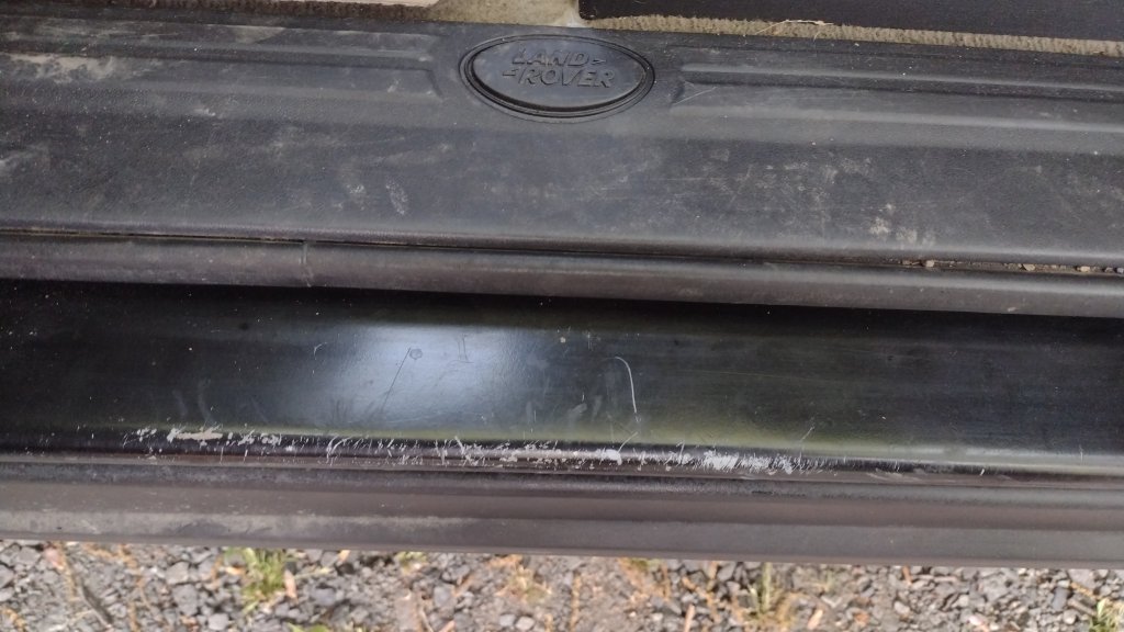

So these scratches bothered me

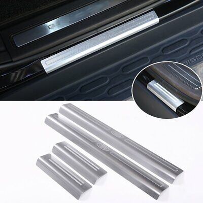

Found this (d4 sellers want $150....d5???...$30

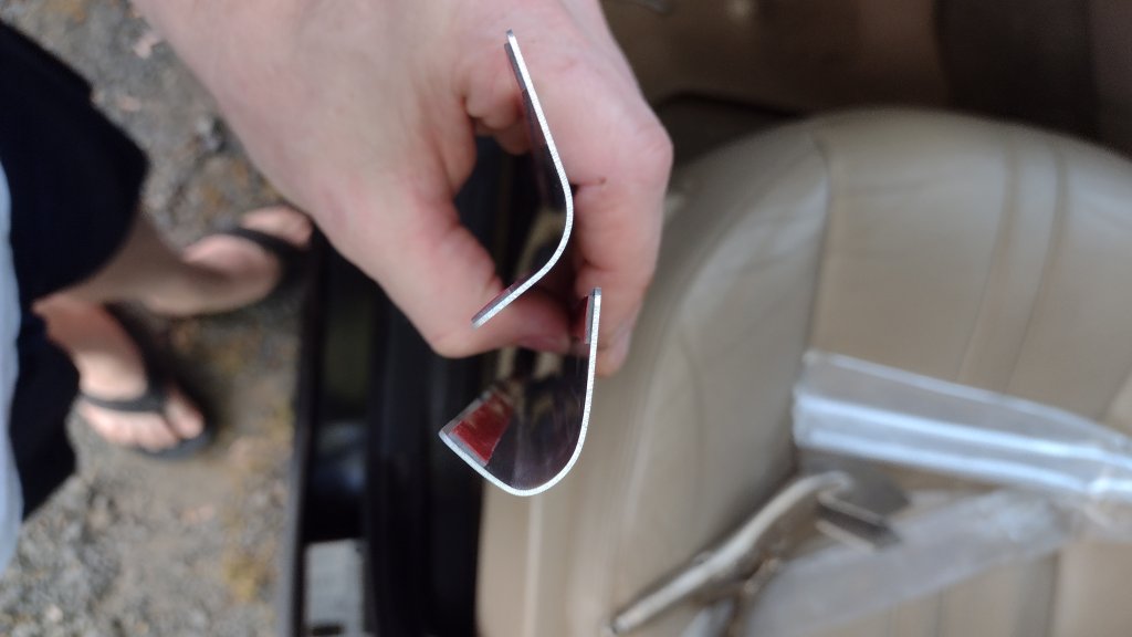

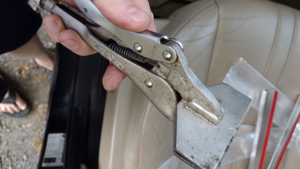

Reformed radius

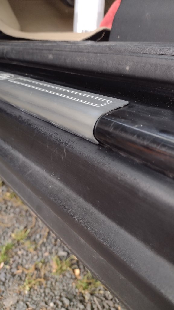

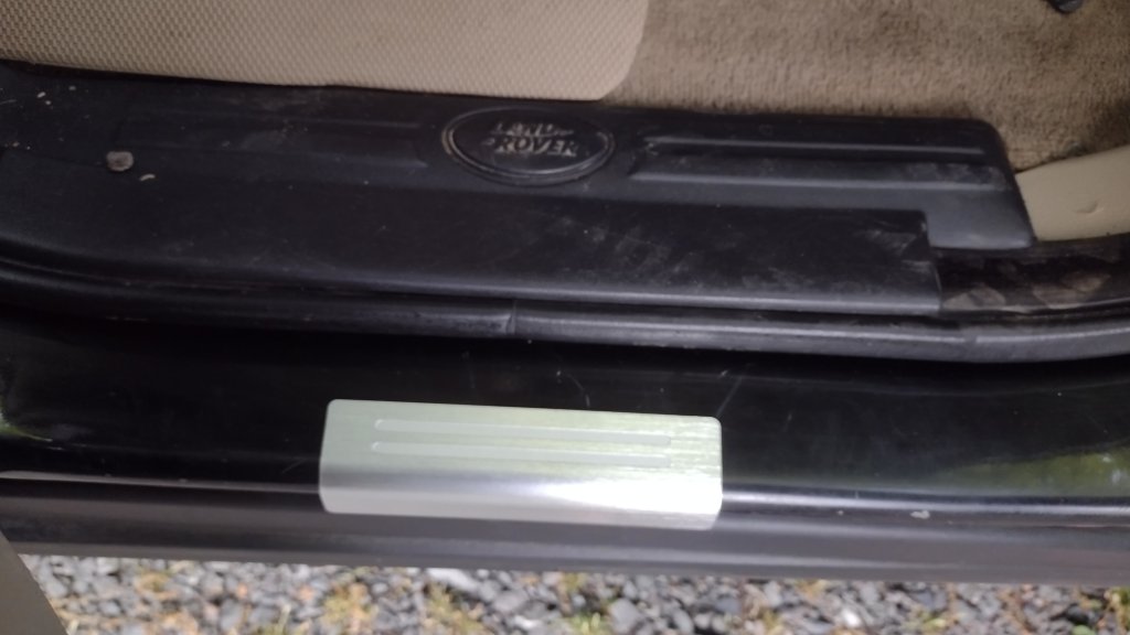

ocd relief
Dont know about wind noise....if I dont add "noisy" to post... it still seals

Obviously too late for most of us, but you can install paint protection film and prevent this before any damage is there.

Yep, the plates only cover the main wear areas, and the rear are really small.
Started with the vice, then tweaked with the pliers. Door seems to seal just fine, no discernable downsides.
3M double sided is sticking strong after a good isopropyl wipe down on the truck.
