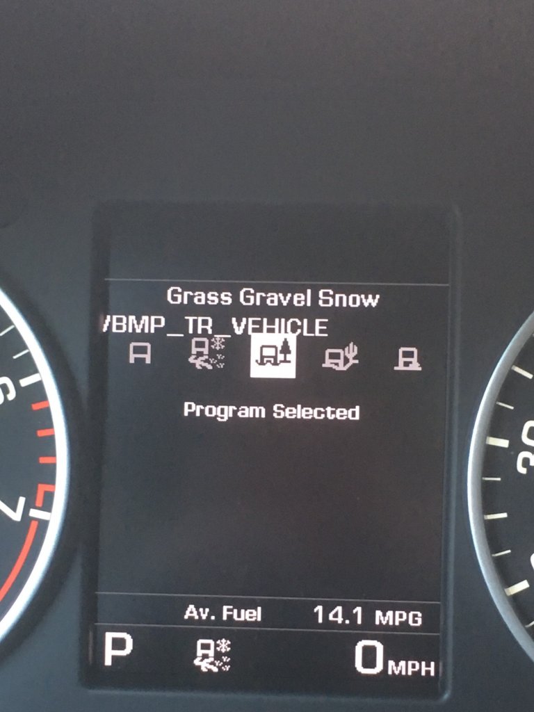

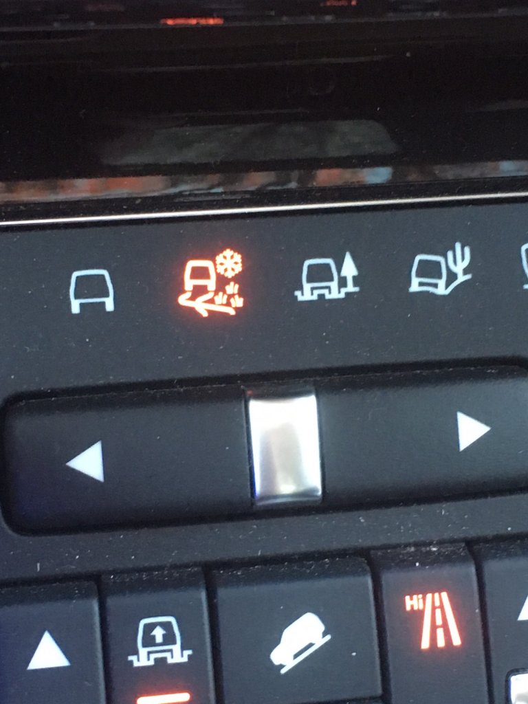

So this is weird (and my dealer is worthless...but that is another story). I am pretty sure since new, the terrain response settings don't agree with each other. between the instrument panel and center console switch area.
In the first image, "Grass Gravel Snow" is the top line that is displayed, but the highlighted icon looks like the mud/ruts. The second image shows the "Grass Gravel Snow" icon illuminated in the
Also, it seems odd that I get something that reminds me of a dos prompt, "/BMP_TR_VEHICLE". It seems weird if this is normal but since it's English I'll go with it...curious what others are seeing.

My Terrain Response is out of sync as well. 2016 Lux. Assumed some sort of software SNAFU and dealing with the dealer on this would be a pain.

Update - So I never ordered the IID tool but I did bring my LR in for service and had them look into this. Dealer was able to resolve it.
From the service record: "...cause: internal module software error, 889003 Instrument Pack - system diagnosis - includes configuration of new ECU 46WPL97"
I know I mentioned it in a prior visit, but it must have not surfaced until more recently.
